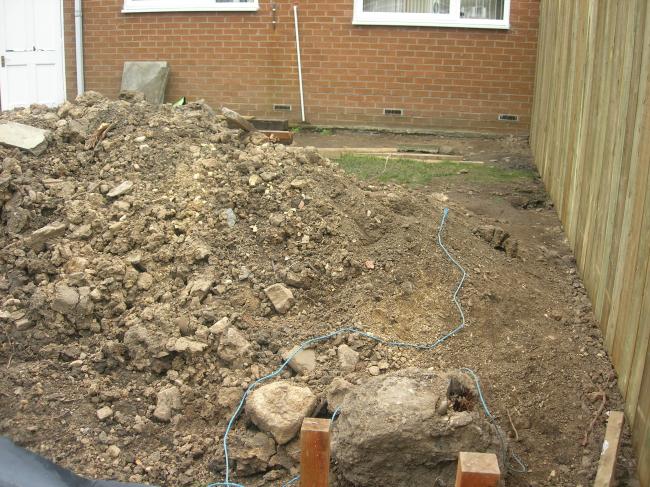

Hi all
I've decided to build a retaining wall in my garden using new 8" thick treated sleepers. The wall is 1.8m high, so what I've thought to do is stagger the ends for strength and use steel ties and deadmen where possible to fasten to the rock behind.
Does anyone have any advice on how I should set the initial row? Some guides just stand the sleepers on gravel, others use rebar, and some concrete.
Due to the bedrock below my first row, digging for posts isn't really an option so I want to be sure it will be sturdy. Driving rebar in may be tricky but it may be my only option. I had wondered if the gravel is to aid in drainage so the wood doesn't rot?
Thanks for any advice

For a retaining wall 1.8m high you are advised to have it designed by a structural engineer, should it collapse (and the non-designed ones sometimes can) it could easily kill the victim beneath it at the time should it fail.
This one isn't really doing any retaining in the usual sense. I've excavated a cliff face in the back garden and really just want something to cover it up and perhaps hold back the bits of topsoil which sometimes spill over when it's raining.
The existing cliff face hasn't moved anywhere or dropped soil for at least 6 months, and has survived the winter without any issues.
when we do them, we normally sink in vertical sleepers in post holes behind and then fix the sleepers to the front of them. We use a small amount of lean mix to bed them on, purely to get them level. They dont need any real bearing as long as youre on good soil as described. WHere it has been more of an issue we have laid them on a normal trench foundation with re-bar protruding behind and backfill behind with concrete.
we normally lay the horizonatal ones like brickwork. Not much point in securing the threaded rod into the rock, as if that moves then so does the wall.

Thanks, Thermo. That second pic looks like the sort of thing we're after, I'm trying to do this with no or little concrete- an eco challenge!
What I'm going to go for is to lay the initial course on a trench of gravel, and drive some 4ft rebar through into the bedrock. Then each additional row I'll set back 1/2" to lean it into the hillside.
I've been reading up about using deadmen on the 3rd/4th row as a form of counterweight, so will put as many as possible in, and will keep the wall as low as I can get away with.
It'll be based on this design with the addition of rebar for the bottom row of sleepers:

way over the top, but up to you. you can bed the first course on some mot if you prefer rather than concrete

Thermo: It's funny as depending who you speak to either say it'll flop right over or it won't. :D I want to set a balcony rail along the inside so that's why I'm going for belt and braces. Nice to know that what I'm going to do is too much though, definitely better than not enough.
lost count of how many weve done, using the vertical sleepers behind. never ever had any move, let alone flop over

However, I've done something similar and all on my jack jones; and I didn't go anywhere near those lengths. I used landscape sleepers laid horizontally. To fix them is I used 5" posts which were 2" in the ground fixed with concrete. I then sloped the posts between 3 and 5 degrees. I then also left a 1" gap between the soil that was being retained and the sleepers.
They've been in just over two years and are not moving anywhere.

Mine was done similar to maf20. I used 8ft concrete fence posts buried in the ground, by 4ft. Angled these slightly to create a batter on the wall. Then just stacked sleepers long edge in a brick bond pattern. Each sleeper was bolted through the posts with 10mm studding. Big square washers and rounded nut on the face. Looks great and I must take some pics and upload to that site!
