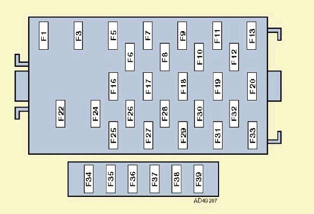

If you pop the controller out have you got 12v between red B3 and black A2?
Autodata says it is fed from F10 (15A) but it might just be a generic description.
I was hoping to check the fuse first, but they aren't labled as wing mirror and some are writing in what I assume is french..
which one is F10??? :)
but the front fogs work.. so it's not a fuse..
means it's the switch then I suppose..
