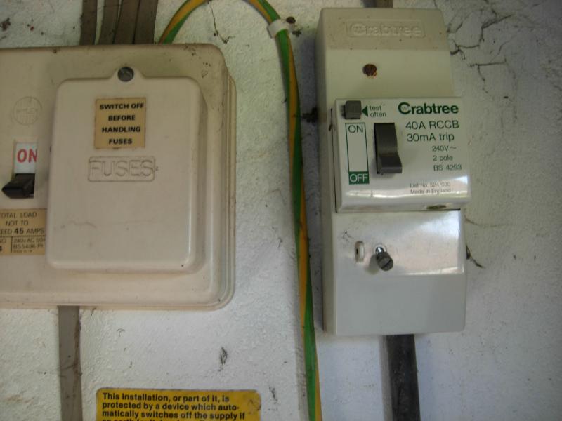

Hi,
I hope someone can help please
I have a Crabtree 40a, 30ma trip, RCCB in the garage (brick, nice and dry) which has tripped earlier today and cannot be switched back on!! I have removed all plugs from the garage circuits, switched power to the garage off/on and still no ability to get the RCCB to stay on with the on/off switch. Power (238v) is getting to the unit, but as expected nothing on the output side. It has been in situ at least 10 years and all wires in/out are nice and tight. All wiring looks sound with no rodent marks etc. Do RCCB's ever fail, as I cannot see anything else wrong?
Many thanks.

Thanks for the replies, sorry I should have made things a bit clearer. Yes it is a detached garage, with a feed from the house main Consumer Unit. I have switched this off and back on and no difference to the garage. No external lights off circuit, and no work carried out in the past 10 years. A deep freezer is out there and was on, but is running OK off a temp feed from the main house. Nothing else was switched on when it the RCD failed.

Switched the whole house consumer unit off, which in turn broke the feed to the garage, was hoping, like you say, this might have cleared the garage RCD, but alas no!! Checked all sockets, no rust, breaks etc. so looks like RCD defunct?
It seems that you have double trouble there: 1) Certain RCDs won't reset if they have no power to them , and 2) it's likely that you have a leakage fault (quite possibly a Neutral to Earth fault, as ColJack has mentioned) which is the main reason for the tripping.
Before you condemn that RCD, try this: Isolate it as before, and then remove the connections on the output side of the RCD (alternatively, disconnect the circuit Neutrals from their common busbar - and switch off the individual circuit MCBs). Restore the power and hopefully the RCD will reset - in which case you'll be left with a process of elimination to locate the leakage.

The RCD is permanently in the down (off) position, if you push the lever up, it immediately comes back down to the off position. There is no 'mid' position. When it is light in the morning I will try removing the output side wires, and report back!

Ok, in the cold light of day, nothing has changed. Turned off supply to house, and in turn garage, removed both wires from the out side of the unit, and replaced same. Power back on to house, but nothing registering on the output side of RCCB. Unless anyone has a different angle on this, it looks like a new RCCB?

'Triple': I hope you don't mean that you removed those wires and replaced them immediately without trying to reset the RCD?
The purpose of that exercise should have been to remove those wires and then to restore the supply and try to reset the RCD with no output connected. If you have indeed done so, and the RCD still wont reset then I'm afaid that you will have to replace it.
Is it a standalone unit - or part of a small consumer unit?

Sorry if not done correctly, but below is link to photo of offending RCCB!!
