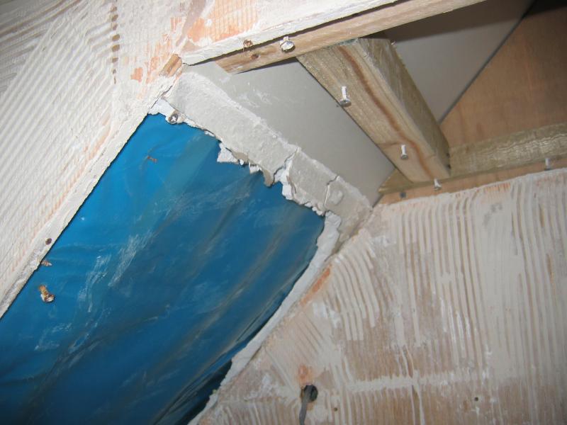

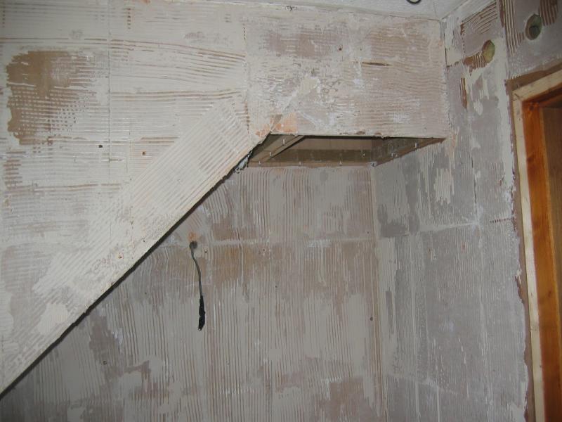

Hi guys,
I thought Id ask a few opinions on this. As you can see from the photos below, I have been clearing all the old tiles out of my ensuite bathroom and one of the problems I have come across is that a small section of the sloping wall/ceiling was tiled directly onto plasterboard. Of course removing these tiles destroyed the plasterboard but the problem is that the plasterboard section goes on beyond the vertical plywood panel as it is part of a longer section of wall.
So... Im thinking im gonna replace it with a section of plywood which will probably be a better solution than what was there before. The problem is this;
because the point at which the two surfaces meet is not at a roof joist, I can only anchor this new piece along the left hand side and horizontally where one horizontal member crosses the area.
I hope that makes sense and if not then hopefully the pictures help make sense of it.
Im also a little concerned with puncturing the blue plastic.
Anyways, I thought Id get some opinion and see if my thinking is sound...
thanks,
Paula

That’s a tricky one; I would still use 12.5mm PB or a cement backer board rather than ply. It’s much easier to cut & work with than ply & I don’t like the idea of using ply as a tile base anywhere other than floors. The downside is that you’re going to be restricted on tile weight, what size/weight were you planning to use? Their doesn’t seem to be any intermediate noggins (cross support) which is a bit worrying which, again, will reduce max tile weight; you don’t want the lot falling down on you!
You’re going to have to provide support down that r/h side somehow. What’s on the other side of that wall, is there access to the sloping ceiling (the other bit of the PB) on the other side? A possibility is to take a piece of 12mm ply & fix it to the backside of the plasterboard full length of the sloping bit, screwing through the ceiling on the other side of that wall. It’s needs to be wide enough so you can get a closely spaced & staggered row of screws into it on the other side of that wall & leave a flange, say, 50mm wide onto which you can fix the new piece of PB down that r/h side. Does that make sense!
