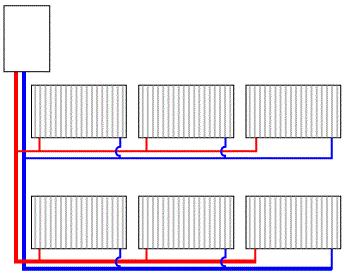

Hello all,
I'm fitting TRVs to my radiators (see layout below), if I turn all the TRVs off I get a fairly unpleasant noise coming from the boiler and I've been advised that a auto pressure release valve would be a good solution? Is this right, and if so where should I fit it?
The pipework from the boiler and feeding the downstairs radiators is 22mm, the pipwork upstairs is all 15mm. The boiler's a Baxi Duotec 28.
Thanks,
Russ :)
ITs not auto air vent ,its automatic bypass valve you need fitted
Normally one radiator usaully the bathroom has normal lockshield valves,so act as bypass
Bypass is there to protect the boiler and its heat exchanger from damage
You need an auto bypass valve.
It needs to be fitted across the circuit after the pump and before the motor valves ( if any ).

Thanks for the replies so far. :) I've not got any motorised valves fitted, how far from the pump should it be fitted? I think I remember reading before it should be fitted a certain distance from the boiler, something to do with the temperature of the water returning to the boiler?

The Baxi Duotec has a built in automatic bypass....
From the installation instructions:
"The boiler utilises the primary side of the DHW plate heat
exchanger as an automatic integral bypass"

Most of the bypass valves inside boilers are designed to protect the boiler and so most of the boiler instructions still ask for an external one or similar arrangement.
That boiler method seems seriously liable to scale up the plate! It may be adjustable and might not be best set.
Tony
Can't see anything in the instructions that refers to adjusting the automatic built in bypass, there's also no mention of having to fit one externally either.
They're probably relying on not all rads having TRV's.

Isn't this going to conflict with Part L regarding the interlock, if the TRV's shut down, the room stat aint reach temp and aint gonna click off the boiler, the boiler will keep cycling, anti Part L, take off the trv on the rad that the room stat is in, this will be your byepass and stop the boiler making a noise.

Actually, it's a little more complicated than that - we're using a system called Homeheat (or IQ3), where each room or zone has its own thermostat, that controls one or more mechanical TRV heads. So we can control the temperature in each zone and the times that the zone is on.
The system can also control the boiler based on whether or not any zones need heat, but we've not got that installed yet!

Take a couple of heads off until you get it fully installed then.
I would still cut an AVDO auto by-pass into the circuit, just to reduce the pump noise, if nothing else.
