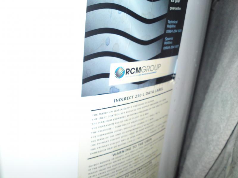

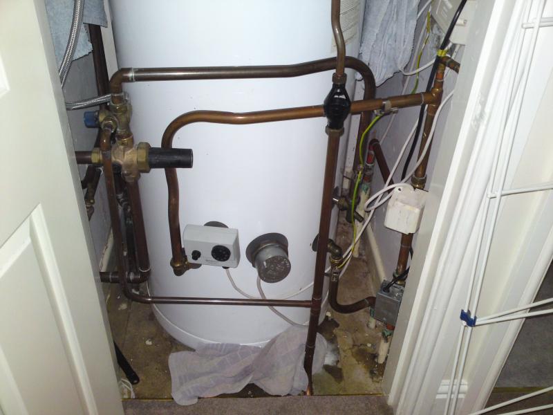

I have included pictures, the boiler tank is leaking from where the immersion heater is connected and so the boiler (Vailant ecomax ???) has shut off. How would I/someone fix this, and is this DIYable? It is leaking from underneath - and appears to be coming from the join with the nut to the silver body of the heater. Is it a simple case of tightening with an immersion spanner. It was installed 6 years ago.
If and more info is required let me know, thanks.
//www.diynot.com/network/user_album_update.php?album_id=5650
I can't see where the leak is from these pics (maybe I need my eyes tested).
What makes you think the boiler not working and the immersion heater leaking are related?

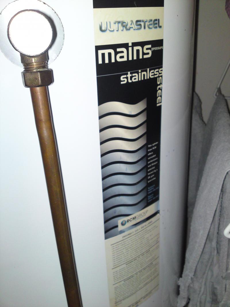

They happened at the same time? I thought maybe a loss of pressure or something would cause it to happen. I have the boiler manual so I'm going to see if I can go and understand why it's shut off. Also, the water isn't visible on the pics, but it's falling from the underside of the join to where the damp patch and towel are on the floor. I'll see if I can get a better picture.

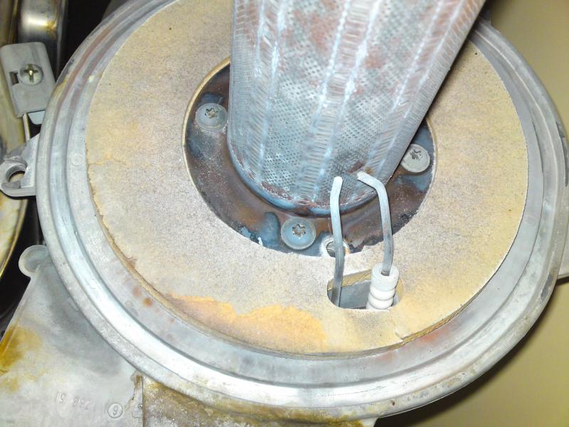

The fault on the boiler screen in actually F.28 - Boiler goes to lock out:
No gas
Insufficient gas
Incorrect gas valve adjustment
Electrode defective
Ignition lead defect
Electronic igniter defective
Check air inlet duct
Which is surprising - 2 problems in one I have tried starting using the button and it went on for a little while. I'll see if I can run through some troubleshooting type procedures in the manual. Is it something to do with having turned the heating off on its scheduled on time? (probably not, but...)
If the boiler is failing to light (or going out) you will need a RGI.
Turning the CH off is unlikely to cause the boiler to show a fault.
Ah, fair enough. On fixing the leak, is it a matter of tightening it or will it be more complicated? Will get someone do it though by the looks of it then just want to know.
Tightening to solve depends on age and existing tightness, more likely to need draining, removing and new washer. Agree a price with whoever you call out before they do any work. A decent RGI should be able to solve boiler and immersion problems.
If you had a large stilson type of wrench you could "feel" the tightness of the immersion heater element as a DIY task.
However, if you did try that isolate all electrical supplies to the area first.
If the washer and thread is coated with silicone before assembly then they dont need much tightness to seal. But usually this is not done and then could need a lot of torque to seal.

Quote. It is leaking from underneath - and appears to be coming from the join with the nut to the silver body of the heater. End Quote
If this is the cast turn off the power to the immersion heater and dont use as behind the silver cover are live electrics. Once you have switched off power and removed the fuze to be safe, you can remove the siver cover and confirm if it is in there. Normally where themostat goes in.

Yeah, it's done up really tight - and the heater is double pole isolated and always has been so no problems there. Draining and a new washer it is. :D

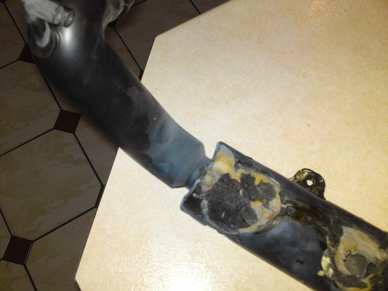

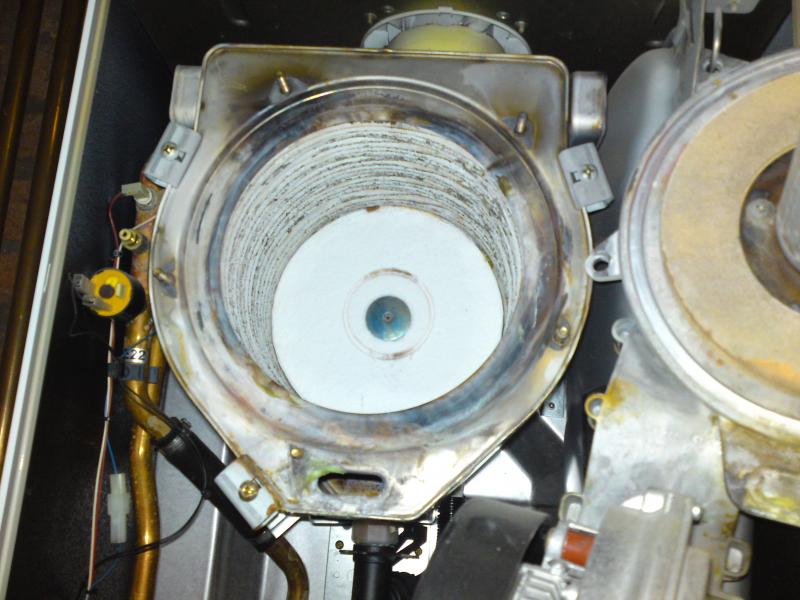

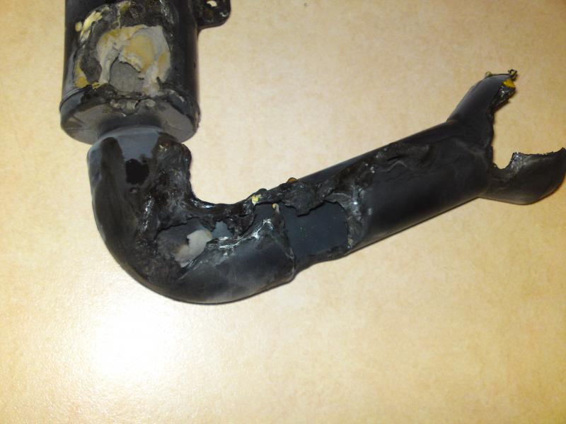

I know how we love pictures on this site, so here are some pictures of the internals of the boiler that has broken down. It had been untouched for 6 years. The guy who took it apart is replacing two parts, 'servicing' it and fixing the leak for £185 - reasonable?
