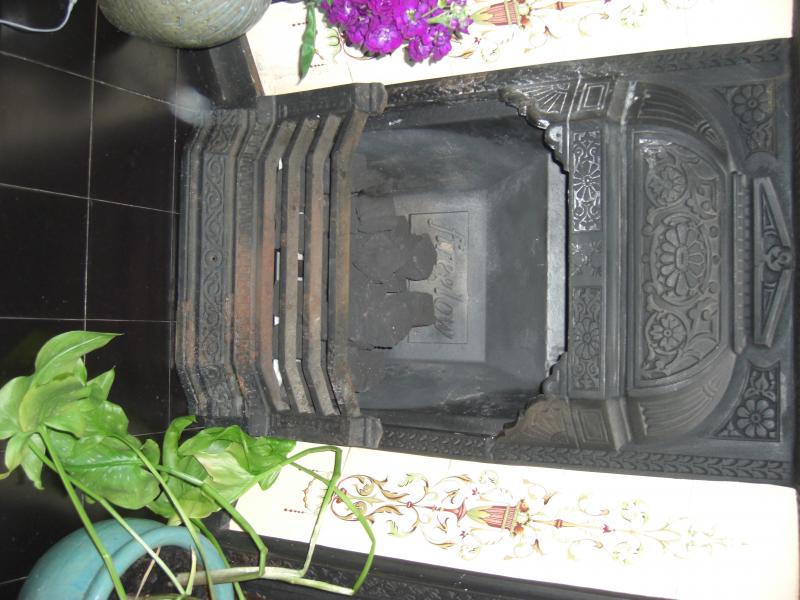

A pic or too would help of the termination plus make/model of fire before i can comment
Thanks for the response - sorry for the delay.
I have attached 2 photos - one of the fire - it's an open gas fire and not sure of make / model as cant actually get to any identifying features on it
The other photo is of the chimney / flue and the cowl.

I normally disconnect 95% of those fires too! Most are in a terrible condition and poorly installed. They are often only 20% efficient (or even less) so it's cheaper and much safer to use an electric fire. Is that the only form of heating in the living room?
I'd like to know how the liner was fitted at the base of the flue...was the cast register grate removed?
I suspect the liner runs to the top of the chimney pot and connects directly onto the terminal.

I'm no expert on how the liner was fitted at the base but it doesn't appear to fix directly to the fire or surround. The liner drops down the chinmey and then there is lots of what appears to be filler closing off between the opening at the back of the fire place and the liner - does that make sense?
