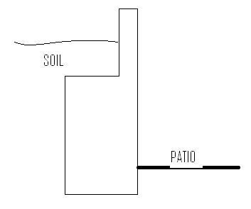

You could build the wall from normal or hollow concrete blocks and then render them. If you want them to look thin from the top just build a normal thickness retaining wall and then just do a thin top course lined up with the front of the wall. The soil will cover the step in the back of the wall.

I meant not so deep from front to back so once the soil is there it gives the impression that the whole wall is much thinner than it really is. So most of the wall might be 225mm thick but the top course only 100mm or whatever you decide. But the top course would be lined up at the front with the lower courses so it looks like one wall.
