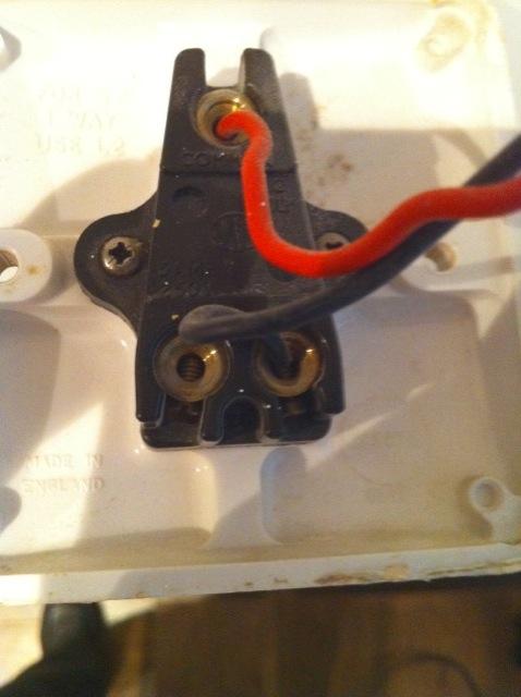

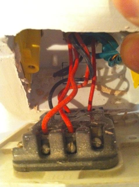

The sockets weren't initially next to each other one has been moved next to the other after we combined two rooms. One is obviously the single 1 way. The other looks like it was a two way but has had a feed taken to operate the outdoor lights and made a two gang? Definately has no more than 2 switches operating it.
Don't see a problem, Are you sure the sg is only one way? looks to be two black wires in pic. Also all black wires should be sleeved in red/brown.
I can only see one black to the single gang switch.
All of the earth wires should be brought together in that terminal block and sleeved with green&yellow sleeving.
If your new switch is metal then you need to run an earth wire from the front plate to the earth connx block.
Single gang is definitely one way. Am replacing with s/s switch so will obviously make sure it's earthed properly.
