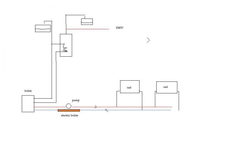

I am in the process of hacking my central heating about, did have a vintage oil boiler but have decided to go green and get a log burner with back boiler (rated at 9kw to room and 9kw to water) the existing system has a 28mm gravity dhw circuit which is fine and a 28mm vented heating circuit,
I plan on incorporating a 9kw electric boiler to boost in the morning when the fires gone low overnight however they are all 22mm and I am unsure if it would be fine to simply plumb it into the flow side of the back boiler incorporating the existing pump or should I go across the flow and return and fit another pump?
Anythoughts?!? i'm sure it wil work either way but want to make it as good as poss!
See attached image [/img]
If your electric boiler is heating radiators only, well all you'll need is to tee into your existing CH F&R & fit a NRV after the solid fuel circulator & add a circulator for the leccy boiler & have a NRV after it. Of course you'll need an open vent on your leccy boiler also.
If you connect in-line like that you'll be heating up the back boiler also, that's the last thing you want to do.

I would have thought the OP was wanting to use it on C/H only until his stove got going. Which is easy enough to do and he can stick in a relay to turn the leccy boiler & circulator off, when his WB stove Hi/Lo stats pull on the WB circulator.
You are fitting a Hi/Lo stat???
