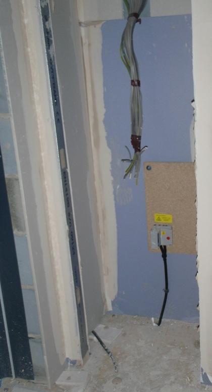

This one is from when the house was being built:

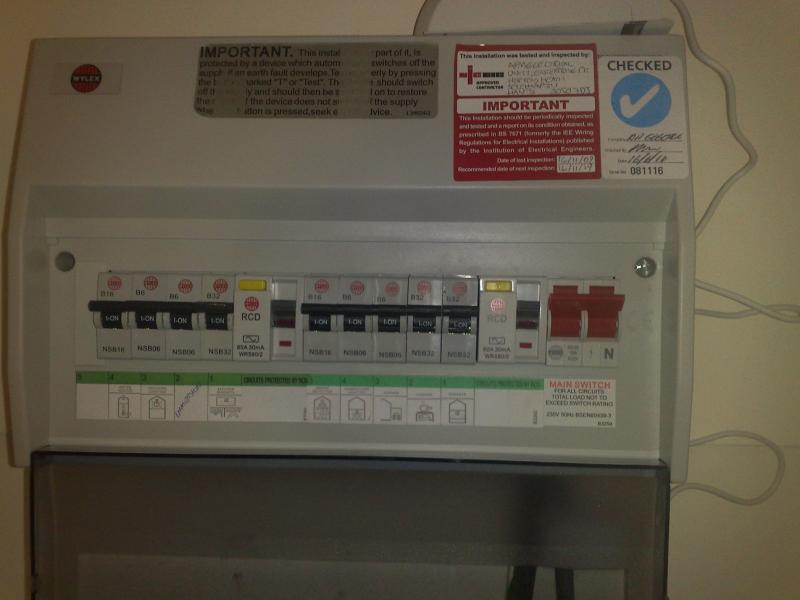

RCB (that's a energy monitor on the top of it)

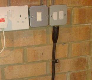

How the cable comes into the garage. The main switch turns all elec off in the garage, the one to the left is the light switch. The cable to the power socket goes into the garage loft, and back down right next to it.

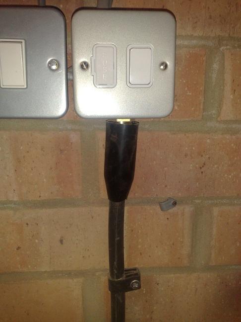

Close up of cable

There is only one double socket in the garage, the one in the pic above.
Oh, looking back at my electrics there is a 100amp fuse after the meter (on the wooden board in the first pic) which then leads to the RCB (the 2nd pic). The wires then go from the back behind the plaster board.
I shouldn't have said 30amp earlier, I'm just saying that as the site forman said that - but take whatever they say with a pinch of salt. The black cable is armoured, I've seen it before it was put it.
The only thing those photos show is that the SWA is not three quarters of an inch thick.
Please tell us exactly what is tripping. Is it the 6A MCB or one of the RCDs? Is that MCB labelled garage or is it for another circuit?
Hi, thanks for all your replies.
I've just measured the black cable and it is half an inch - sorry for the error earlier.
The switch that is tripping is the 6a switch, the black one in the 2nd pic (middle of the right set of black switches). This trip switch is just for the garage (it says NSB06 on it).
There are four of them but I'm going to assume it's the one with the pictogram which looks vaguely like an attached garage.

I would have expected the switched fused spur unit on the right to isolate the lighting without isolating the sockets.
Could the sockets have been added later?
Change of mind.
The switched fused spur on the right must have been designed to isolate the whole of the garage (which probably only consisted of lighting), the 1 gang switch simply to turn on the light.
I think perhaps the sockets were added later, and were tagged onto this lighting feed.
If that fused switch turns all the power off in the garage then presumably the fuse is not just there to protect the lighting in the garage.
If you upgrade the MCB in the house then the fuse in the garage will just blow when you plug your lawnmower in. You can't put a 13A fuse in it because the lighting circuit must be fused maximum of 6A.
You could get an electrician to check it all and put a 16A MCB in the house and rewire the garage socket into the incoming side of the fused switch but you are getting him on site anyway I would seriously consider getting him/her to put a small 4 way consumer unit in the garage. That way makes it easier in future if you want security lights or a pond feature.

And please, stop calling it an RCB. You have a CU, with a main switch, two RCDs, and nine MCBs.
