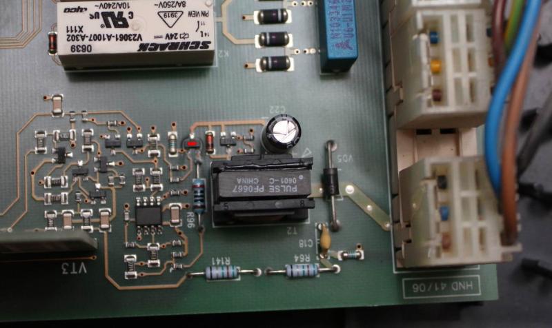

Apologies for resurrecting this thread but I've just had the F4 issue intermittently on a WB1A and fixed it without replacing the main board. It turned out, for me at least, that replacing a single inexpensive transistor was all that was required.
As others have said, the voltage to the ignition module (blue to black) should be ~120V DC when idle and ~300V DC when igniting (Note that there is also an AC voltage present). When mine wasn't functioning, there were zero volts to the module.
The transistor in question is marked with a red dash in the picture and just 8AC on the top. It seems to be a BC846CMTF. When the boiler was functioning correctly, at idle the DC voltages at the base, collector and emitter were 5.5, 16.9 and 5.5 respectively. When not working, the voltages were roughly the same with the exception of the emitter which was at zero. When igniting, the voltage at the base goes to about 9V DC.
