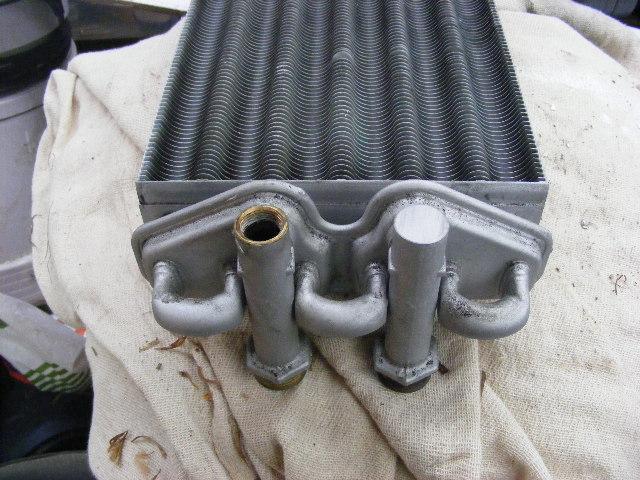

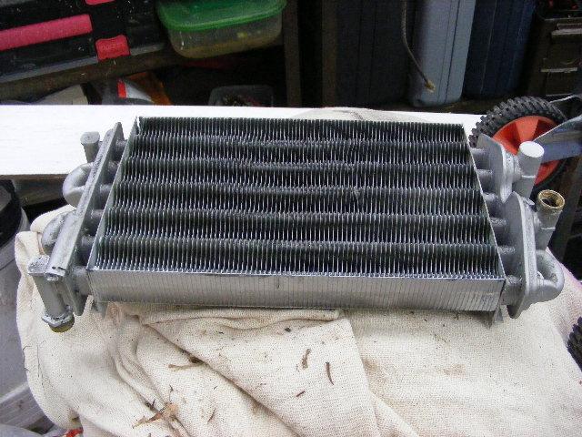

Have a look at pictures of exchanger that came off. DHW seems to be connected to tubes that run through matrix but heating pipes only appear to connect to plates/ is this the only surface where heat exchange for the heating takes place or are some of the tubes connected to some to DHW and some to heating and if so can there be letting by cold water into the heating circuit?

They said heat exchanger is pipe within pipe type, heating water gets heated in outer pipe which conducts heat to inner pipe containing dhw. Because old exchanger would probably have magnitite lining the pipe then it was less efficient at heating dhw. They also said when demand for hot water ceases pump runs to clear the hot water in the heating pipe, though where it goes i know not, because water isn't getting that hot the old pump can cope with carrying this hot water away and there are no problems however with new exchanger water gets hotter and old pump can't remove water fast enough resulting in the kettling and pressure rise.
