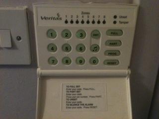

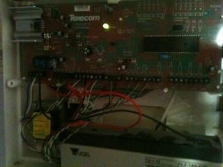

We inherited a Veritas Alarm, we've never used it. I flipped the mains to do some work on a light, this set the alarm off. We cant reset it properly. the 'unset' light flashes green. i removed the main cover, now when i try to play with it the 'tamper' trigger goes off! :mad: Ive followed some guidance elsewhere to remove the battery and mains power, then reinstate both. This shuts off the alarm, but ive tried then entering 4321 prog, 60, 1151 (new code), prog, reset. Unfortunately i can get through this until trying to hit 'prog' after the reset. Basically i just want to factory reset the box. Im not entirely sure which model i have photos attached...
can anyone help...?

ahhhh should have looked at the picture, you have a 2.9 fitted.
Ask him to fit a 7ah it will fit and will last longer in a power cut.
