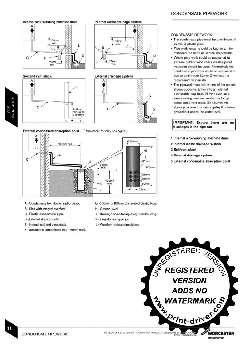

Yes, if there is no suitable drain to discharge into you should install condensate soakaway. McAlpine make a purpose designed product. Basically it's a 100mm diameter by 300mm plastic container that you bury in the ground.
I've placed the relevent page from a Worcester Bosch boiler installation manual showing how it should be installed.
Hope this helps,
Mark

If it's not written down you might be on a sticky wicket with regard to the flue/plume kit although there is such a thing as a verbal contract. The condensate discharge has not been completed according to the Manufacturer's Instructions (probably) or to British Standard 6798:2000 which covers this area. You therefore are completely within your rights to ask for it to be rectified.
