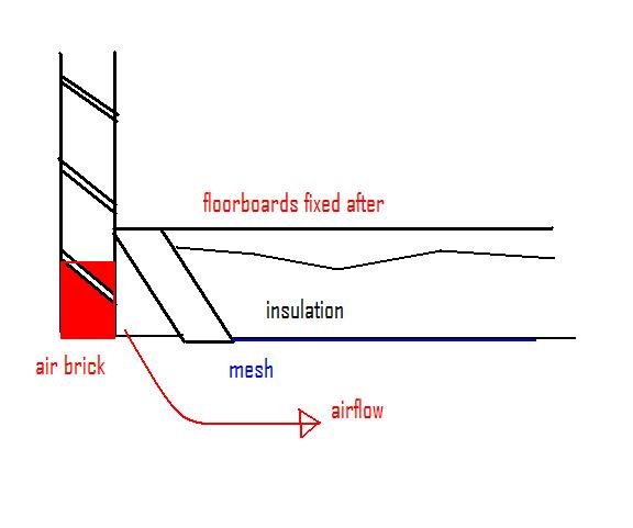

Hi the reason i thought of foil wrapped space blanket was due to the r value being around 4 were as insulation board would be around 2.5 also board is around 4 times the price per sq metre
does the insulation have to be up to the undeside of the floor board? or can it have a gap?
i thought at the wall ends i could put a piece of insualtion board at an angle, with space blanket between those two ends taped on to the boards supported by netting, so as not to block the air flow under the house but to seal the underside of the floor board from the cold but keeping the bottom edge of the beam open to air flow

what happens with the insulation against the wall? can it be pushed up to the wall or will the mineral wool / multi roll suck up moisture do i need a membrane or something
The walls between the joists should all be above the DPC, so they ought to be dry. Condensation shouldn't be a problem with adequate sub floor ventilation. Any water pipes beneath the insulation must be protected by thick (bye-law) insulation.
