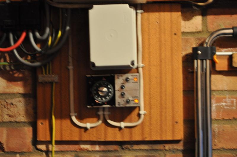

Some lugs (?) have gone on the timer switch: as you turn it, only some of the time settings are effected.
The switch is in all electric house and switches ceiling heating on and off for a meter showing the two rates of Economy 7 (?)
Two cables go into the present timer switch (no name visible).
Can I replace it with something like the Horstmann Economy 7 switch?
Presumably the current passing through the actual switch is well under 13 amps.
Any help would be most welcome.

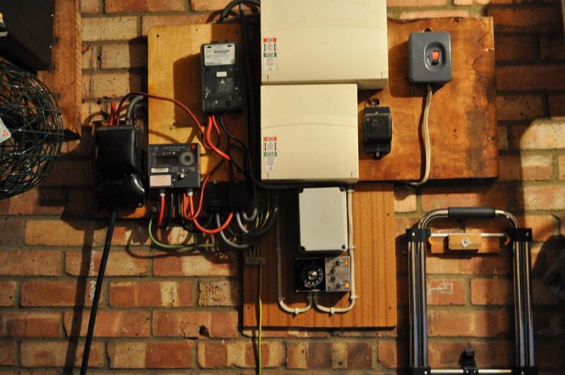

Pictures please of the switch, the fuseboards and cables between the incoming supply and this timer.
