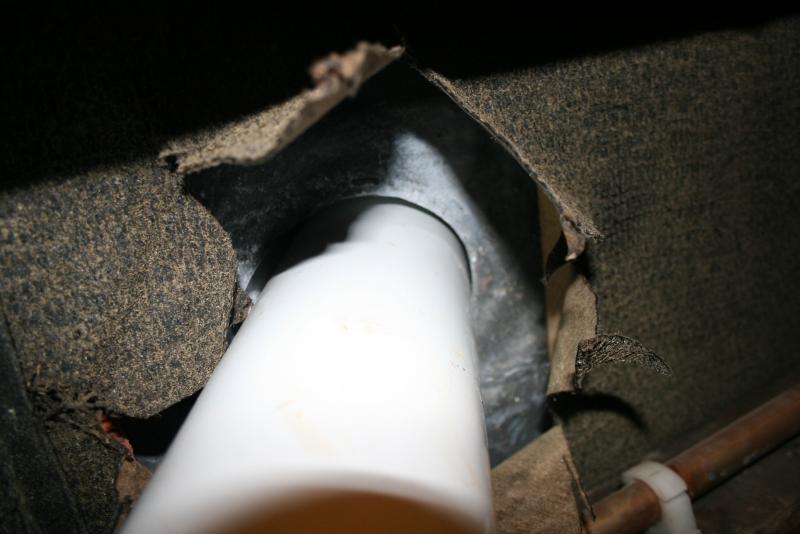

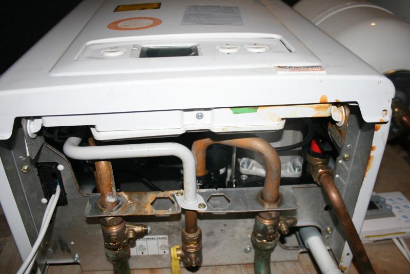

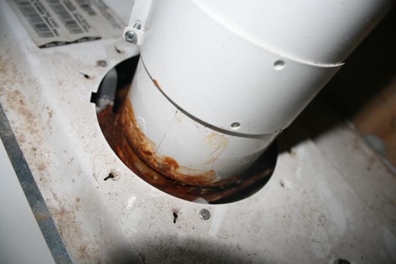

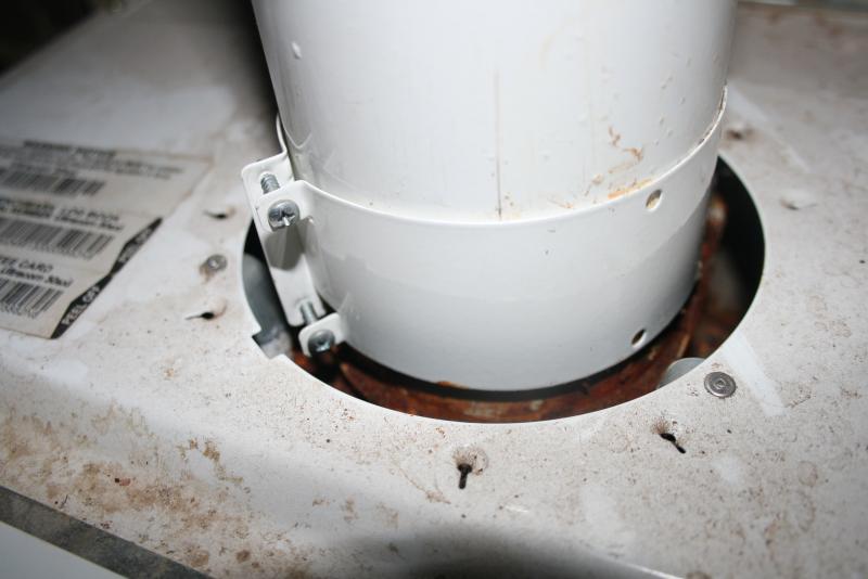

Does this sound right? i tried taking a few images to point out the issues, you can see where th drip comes out of bottom right hand side and the top where the fleu sits is all rusted.
would really appreciate if anyone could tell me straight if this is a installation problem or a fault with boiler.

There is a turret that must be fitted to these when they're converted to vertical flue. Picture shows water ingress which doesn't appear to be from the boiler.
Why no turret? Metal flue connected straight to boiler surely is incorrect.The turret would have all the correct seals etc.If you have a copy of installation instructions,all the relevant info will be in there.Having said all that, a leak on the flue wouldnot cause system pressure to drop.You have seperate issues there.

very poor installation, there should be a turret on the boiler with a correct seal and a flue sample point, this looks very dangerous!!
Thats clearly dangerous. The flue seems to be connected directly to the flue adaptor and the there is a gaping hole straight into your boiler ! Shocking !!

You can have no argument with Glowworm, the installation of the flue is disgusting and has obviously caused the water damage.

You can start by asking Gas Safe to come and inspect it and give you a report.
It will be so damming that you can then ask the installer to put it right which will probably involve a new boiler.
