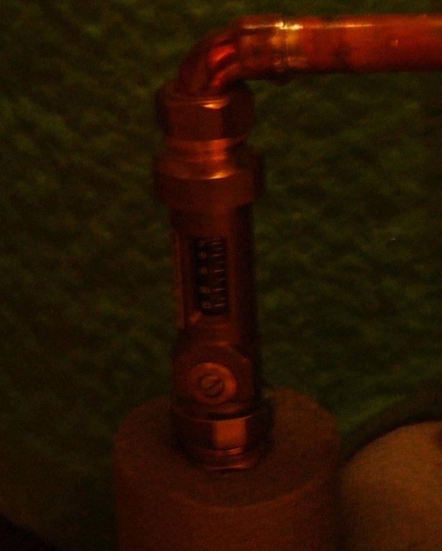

Looking at the pipes, I've noticed what looks to be an automatic bypass between the primary after the pump but before the split and two motorised valves.
It passes through what to my unskilled eyes looks to be an automatic valve and then back to the primary return. It's in 15mm pipe.
Two questions:-
Am I going to run into problems if I put TRVs on all the radiators? I thought that by-passes needed to be 22mm?
Secondly, could this 15mm pipework and valve be the source of a noisy few minutes after system shutdown? Would a 22mm bypass cure this, or are the by-pass valves inherently noisy?

The noise is a loud whirring/whistling noise that comes from the area of the pump/valves and what I think is the by-pass valve (they are all within a foot of each other in the loft). It lasts up to 10 minutes after shut down and rises gradually in pitch. It is much noisier than the usual running noise you get from the system.

The boiler has a pump overrun, which keeps the pump running for several minutes after the boiler goes off. You can probably hear the water passing back to the boiler through the bypass valve. The rise in pitch is probably due to the valve slowly closing. It shouldn't make this noise.

Thanks for your help so far here's a pic of what I think is this bypass valve:
Must admit i have never seen this type of valve before in near 40 years It is not however, an automatic valve of any kind. It is manual. It has a flow guage to register the flow through the bypass and a screw valve for adjustment.
The noise on shut down will be caused by insufficient flow through this valve (it is nearly shut).
Fit a new automatic valve when you change the valves and yes they are 22mm.
I'm guessing that the rising pitch will be because the system pressure is going up as the pump works against the valve?
I've had a better look at the valve body now, and it's a Taconova Setter valve. It's set to the right-hand "B", whatever that means. I googled it: specs here
I'll have my plumber take a look at it when I get the rads replaced and see if he can fit an automatic valve in its place in 22mm pipe.
