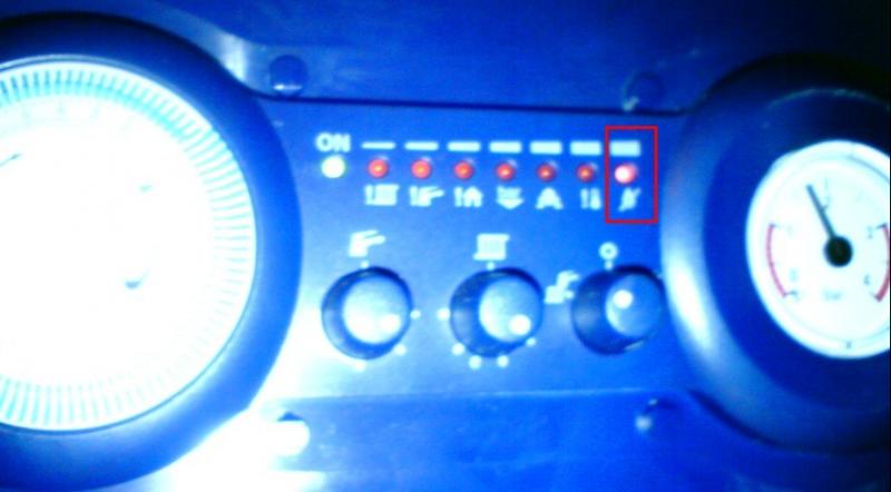

Heatline Vizo 24 not working as red light keep flashing!!! see attachment photo.
The boiler seems working prefectly fine when the fan starts running, then sparking commence, afterward burner ignite. BUT after about 5 seconds it shut off, and the red LED light starts to flash. The red LED light Flashing which means "Flashing Flames or Gas Failure" as stated in the manual. And i tried to switch to the "O" position which will restart or reset it. BUT same problem occurred. This happened about 10 times since it was discovered. But everytime the fault occurred, it will work the day after. BUT this time does not work at all. PLEASE HELP!!!!!!!!

The condesate outlet pipe is either blocked or more likely frozen!

Hi Tony, nice to see you replied again, i had poured hot water over it, but fault occur, by the way, the boiler only 6 months old. No problem at all in the summer, until end of october as fault started |

Pour more and pour it slowly... |

A quick question for you!, do i pour into the pipe or the surface of the pipe? |
