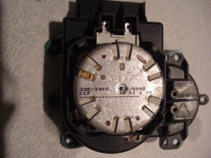

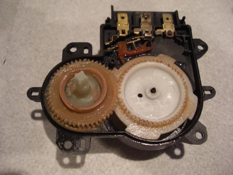

PostPosted: Mon Jan 03, 2011 6:08 pm Reply with quote
Stripped it down today and sure enough the blown triac does control the motor for the spray arms.
I opened up the motor assembly and it had a good amount of water inside (the water is glissening in the attached photo) and you can also see dirty water stains on the underside of the motor housing (see other photo) so it had penetrated through. It's frustrating that a simple rubber seal caused 250 worth of damage.
Considering the cost of the replacement parts, it's age (9 yrs) and that this seal is likely to be the first of many to go, I'm reluctantly going to scrap it. icon_sad.gif
Thanks for all your help.

PostPosted: Mon Jan 03, 2011 9:20 pm Reply with quote
Thanks for the feedback. At least you can console yourself with the fact that you didn't waste a bunch of money on a new pcb just to have it blow again...because that is what would have happened. Its a shame to scrap a machine all for the sake of a defective 20p o-ring but think you made the right decision. Better luck with the new one icon_biggrin.gif
