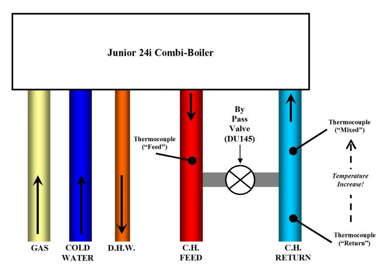

i have a worcester bosch junior 24i combi boiler fitted with a honeywell DU145 automatic by-pass valve. What i wish to know is when is the boiler operating most efficiently? I believe that this occurs when the differential central heating water is above 20degC, ie the difference between the feed and return temps. I have taken temp measurements on my system and I only see a maximum difference of 15degC (see attached plot). Is this what I should expect or should the differential temp be higher and for a longer period?
How do I know that the by-pass valve is set up correctly, as it seems to allow hot feed water seep through the valve at all time, ie when all the TRV are fully open (the radiator in the hallway has no TRV)!

The boiler's heat exchanger has a makers maximum for the delta T. Stick inside it or you could have a cracked heat X.
The auto by-pass valve should not be passing when all TRVs are open. It may have crud on the seating (very common). If you are replacing the valve also install a Magnabooster filter on the return pipe as this will grab crud.

All radiators should now have TRVs and all systems an auto bypass valve. The days of a rad with no TRV to act as a bypass have gone!

Thanks for the replies and I apologise for the delay in my response.
I have inserted two more images; one shows a schematic of the boiler measurement positions, and the other shows the return temp (before the bypass valve) with the "mixed" return temperature (after the by pass valve). This plot clearly shows that there is a constant increase in the return temp past the BPV, which indicates that the BPV is allowing hot water through at all times. Am I therefore correct in assuming that the Gas Safe engineer did not set the BPV correctly? He took it straight out of the box without adjusting it. He said that it is "pre-set!"
The plot also shows that the return temp goes above 55C after 30 minutes, thus the boiler will not be in condensing mode after this point. Is it best to set the boiler to a lower heat setting to ensure that the return temp stays below 53C?

A condensing boiler should always be set as low as possible to optimise efficiency.
Have a look in the manual to see if this boiler needs an external bypass; it would be the first WB combi to do so that I have ever seen.
