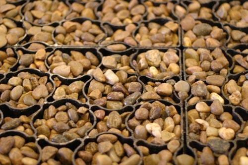

My drive is 55m2 and has been dug out ready for sub base. I have a very limited budget so gravel is my choice.
My question is i can't decide wether it's worth spending an extra £700 on the plastic rienforcement that holds the gravel together and stops it moving this is layed on 30mm sand and is 40mm deep which you fill with your choice of gravel, if you don't know what i mean it's called Hebden 40 you can google it. i have seen some photos of the finshed product and it looks really good.
Or should i just put the gravel down loose? If so what type/size is best to use to minimise movement (10mm, 14mm or 20mm?).
i also intend to sell the house in a couple of years.
Any comments very welcome
thank you :unsure:
Don't bother because this will really irritate you 12 months down the line when you are digging all the weeds, leaves and compost out of the gravel.
Larger gravel is marginally less bothersome than smaller stuff and gives less.
Limit the depth to about 40mm if possible.
Be prepared for some serious raking if you have a lot of deciduous trees nearby.
Riding a bicycle over it is near impossible.
