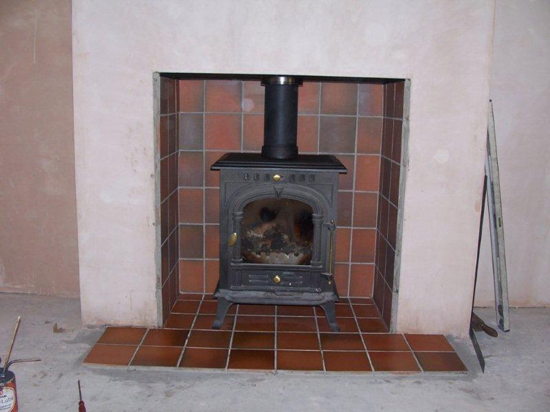

I am in the process of renovating my house. We are planning to install a wood burning stove in the living room and would like to lay our own hearth.
We have a constructional hearth already and need some advice on the types of stone tiles and the fixing we should use to lay the decorative hearth. We don't want to use the wrong things and have the heat from the stove do any damage.

I put a wood burning stove in 5 years ago and used indian stone bedded on sand/cement mortar. had no problems at all.
we put a log burner in my sons house last year. We tiled in the opening with red quarry tiles fixed with cement based adhesive ( not the ready mixed stuff )..It throws out a terrific heat and up to now no tiles have moved.It still needs the surround sorting but its the best thing since sliced bread :D ..Bill
Thanks folks for the replies, really appreciate it. Glad to hear a normal cement mix will be fine, I guess I can get started now!
