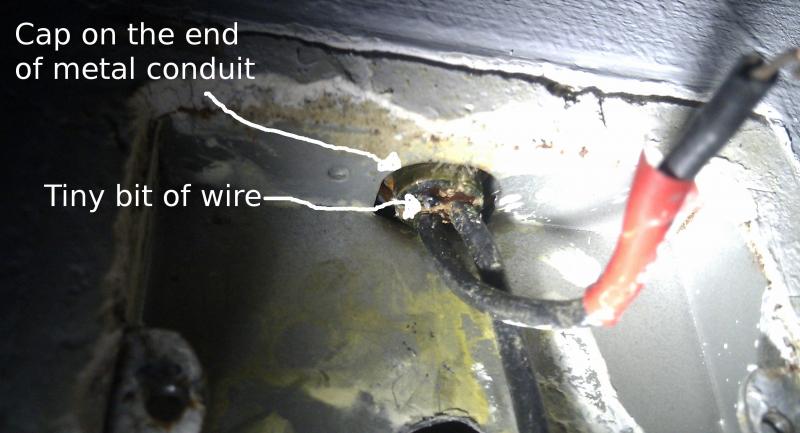

Hi all,
I've got a bit of a problem and i'm hoping someone's got some ideas which doesn't involve re-chasing out the wall :)
Whilst replacing the dodgy light switch in my lounge i noticed that the core of one of the wires was just hanging in the insulation as the copper core had snapped (which would explain why it was dodgy)
I removed the insulation of the wire to see where it had snapped with the aim of doing a repair.
As you can see (from the picture below) there's a tiny bit (1-2mm) of the wire remaining this side of what looks like a cap. I know from around the rest of the flat that the lighting circuits are run through metal conduit which is earthed. The cap seems to be holding the wires in very tightly and there appears to be no way of removing it.
* Does anyone know what this cap is and how to remove it? Is there a set of connectors on the other side which i could use to replace it or put a repair in?
If i could remove it i think this would allow me to pull through maybe another ~3-4mm which would mean i could get a chocolate box on there and bridge it.
If that doesn't work I was also thinking about soldering another wire on to the tiny bit which is left and insulating it but as there's a lack of a real earth wire and i'm not behind an RCD this scares me a bit.
* Do any of you have any clever ideas on how to fix it or come across something like this before?
Thanks in advance (It's getting pretty dark in the flat :) )

That cable is mineral insulated cable.
Do not remove the cap. The mineral insulation will get damp, and cause a short between the bare wires inside. Magnesium acts as an insulator.
You will NOT be able to pull any slack on this cable.
To alter this existing cable you will require an experienced electrician who has experience with this cable. There WILL be damage to the walls.
Alternatively, trace where this cable goes and replace with regular twin and earth PVC cable.

Sorry, but that's Pyro cable, not conduit. You'll need to find an electrician to put a new pot on the end of the cable.
Thats MI... if you've snapped the stub off at the pot then the only thing that can be done is to chase out the wall to gain enough on the cable to strip back and re-pot it.
You wont gain anything by pulling at whats left of the stub, and you dont want to take the pot off... its sealing the end of the cable, the mineral inside will readily absorb moisure from the air and fail without it
You need an electrician who has the tools to work on MI (and hopefully various different sizes of pots to try as it is quite likely to be imperial).

That looks like MICC (aka pyro) to me, which means you don't stand a chance of DIYing it, look up micc in the wiki to see what you are up against.

So it's a copper pipe filled with 3 wires (I think there's another hidden rose under the plastered ceiling somewhere) which then had magnesium oxide used as an insulator... Nice... Good job i didn't remove the cap then!
(The reason you can only see 2 is the 3rd one is the one that's snapped :( - I removed the insulation once the copper core had fallen out)
This is going to make a bit of a mess i think as the ceilings are solid concrete and therefore we don't have any access to the wiring up there.

It wasn't a case of MI being used before pvc multicore was invented... before PVC, we had vulcanised rubber (1950's, early 60's) and before that we had rubber insulation with lead outer sheath... 1940's.
No MI was (and still is) used where its properties make it desireble... bare copper looks good in historic buildings etc, and its also completely fire proof, so is often used for fire alarm systems.
In the past though (when labour was cheaper) it did find its way into more installations than it does these days, no one would wire a school's socket outlets and lights in it these days, but years ago it was often done to provide a 'high spec' install
Its probably embedded straight into the ceiling and this will be why its been used on your installation. If you take your ceiling light down you will hopefully find a BESA box behind it that the cables are made off into.
