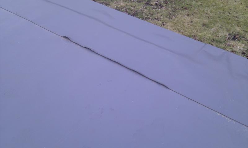

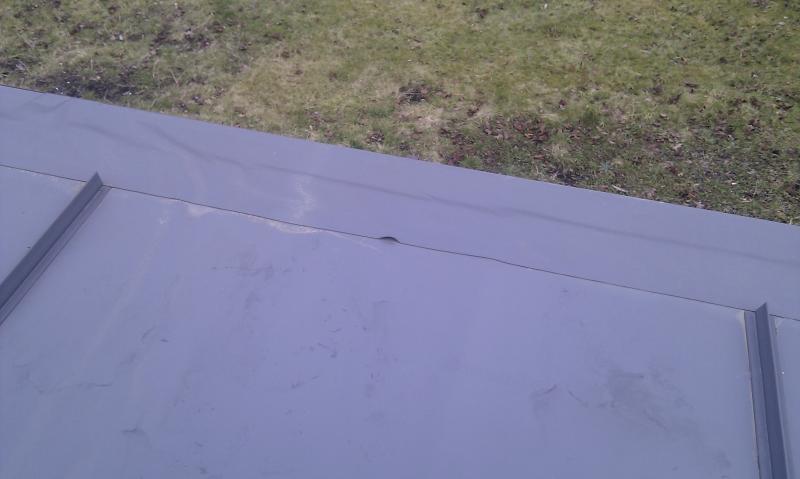

I have a Sarnafil single ply roof installed on my recently completed extension by a professional installer who was sub-contracted by my builder.
After the bad weather in December (and once the snow had thawed) I had noticed that in a couple of small places the edging piece which goes from the last 6 inches of the roof edge over onto the vertical was starting lift off the membrane underneath.
I tried to contact my builder who didn't respond (not that surprising) so contacted Sarnafil who told me a guarantee had been issued and that I should contact the sub (they gave me the details).
Contacted the sub to be told my builder had never paid them and has since gone out of business. I had paid the builder in full months before. The sub is withholding the guarantee and wants me to pay for 50% of the roof again. Sarnafil are largely standing by their installer. Whilst I sympathise with them, their contract was not with me and I have honoured mine with the builder. I can't afford to pay for products twice.
So, can the small edges that have lifted be stuck back down? Is it a glue that is used, it looks like the edge was not properly adhered in a couple of places but I have no idea if this is DIY achievable or would require an expert.
I would rather do it my self it I can.
Any help appreciated!

The Sarna is hot air welded at the joints so shouldn't actually part
The build up is the bottom layer of Sarna goes to the edge, the drip trim is then mech fixed through the 1st layer into a timber edging with a cover flashing strip welded to the top of the metal trim and then to the main field area (1st layer).
Is it the trim that has lifted from the 1st layer or the cover flashing that has lifted from the coated metal trim?

Thanks for the responses.
Its definitely Sarnafil, I have spoken with them and handily they have embossed their brand all over my roof!
I have attached a couple of snaps to show the issue, there are only three distinct places where this occurs and it doesn't look like a mechanical fastening.

Looks like the hot air weld didn't take for some reason
What you could get done is a patch hot air welded over the lifted lap. Not the ideal situation but would at least cover the failed area, this shouldn't cost you a huge amount.
Best to get all the other welds laps tested with a seam tester (looks like a bent pointed screwdriver) just to check that is just a couple of isolated incidents and not endemic across the roof

Thanks for the info.
Just to understand the testing process, if I can lift the top piece and the bond breaks then I have a wider problem but if I cannot easily encourage the seam apart then the bond is secure?
I obviously don't want to cause further damage but if there are issues best confront them now.
Under what circumstances would hot welding failure be endemic?
Is there a bonding agent used or is it the PVC being melted to bond to its neighbour?
I am half thinking that the loose edge could be secure with a PVC glue - the type used to fix dinghys - horrific idea?
I really appreciate your input on this.

No, it is correct, the flashing piece is welded to the front edge of the drip trim then welded to the field area thus creating the inward facing seam

The weld failure can only really be endemic if either the hot air gun (machine) wasn't at a high enough temperature (which is unlikely) or the underside of membrane got wet, PVC absorbs the water and will not weld correctly if the case.
As far as I know you just need to run the seam tester down the weld with a little pressure and if it finds a failure it will go into the seam, another way (and more sure) would be a vacuum test over the seams.
