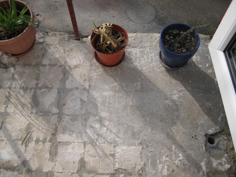

My ground floor flat has a small patio, with a concrete base that very cunningly lifts at the edges and pools water up against the wall. I would like to take the edges off & remaining tiling adhesive before laying a new layer of concrete to provide a slope away from the building.
What's the best tool to achieve this given that I don't want to break the slab up, only take the edges off ?

Its morning, daylight and I can post some pictures :
Patio is approx 3m by 1m.
I had a go yesterday with a good old lump hammer & chisel, managed to do this in ~ 2 hrs before thinking a power tool would be better. For all my inteligence I can be slow sometimes. :eek: Besides it was a nice day.

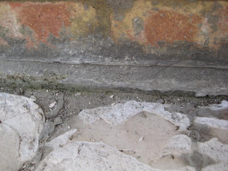

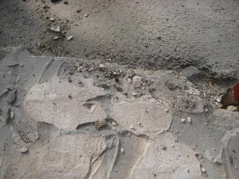

This is what I need to deal with. By my reckonin I need to take the edge back about 6". I also need to repair the leg ends of the balcony that surprise surprise after 40 years have rotted off, but I think I have a solution for that. Just need to find some square tube with a 1" CSA. Or I did the whole thing out and send it off to a fabricator for repair
The only other mild concern i have is how close the slab is to the DPC As this somewhat limits thick I can lay a new finishing layer. comments appreciated.
