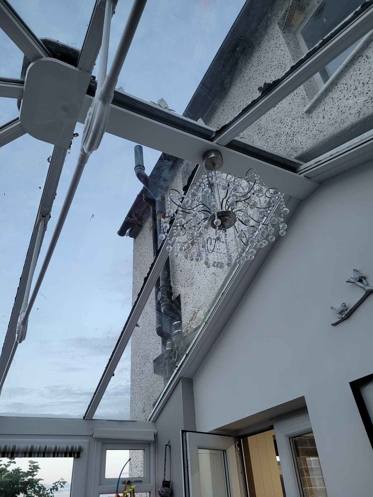

Hi,
I have a very similar situation - bought a new ceiling fan/light to install in conservatory and it clearly says the ceiling must support no less than 35lbs (15.9kg)
Does this look like it can handle the weight? The fan unit is heavier than I'd expected when I lift it.
Many thanks for your help
As long as you get into the extrusion with a couple of decent screws it should be fine. Conservatory fitter did mine for me and used self drilling screws.
