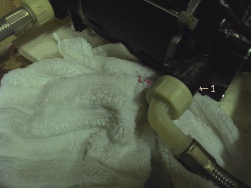

Hoping that someone can help and offer me a little bit of advice.

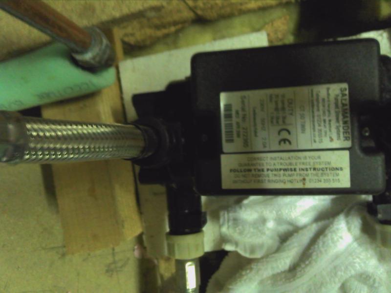

I discoved last night that my salemander shower pump has sprung a leak. Have attached a photo (marked 1) of where the leak is to show the exact location as not easy for me to describe (although funny enough there was also a leak from the white plastic casing (marked 2) as well but have tighented that and it has gone). Both leaks are obvioulsy dripping from the bottom.
Anyway, my questions are:
1) Is there anything I can do to look to resolve this ? The black casing (marked 1) doesn’t appear to have any joints for me to look at, just plastic casing.
2) If I buy an indentical replacement pump, same BAR etc, could I fit this myself ? It looks quite straightforward
The pump has been fine since I have lived at the house, approx 3 years, and whilst I have read on-line that there are better makes etc it would obviously be easier for me to buy like for like so the install is straightforward.
Thanks in advance !
isolate the feeds to the shower pump and remove the flexi hose maybe be just the rubber seal in the flexi has has failed or the black plastic part has a split around the thread.
looking at the pump it looks like a CT 50.

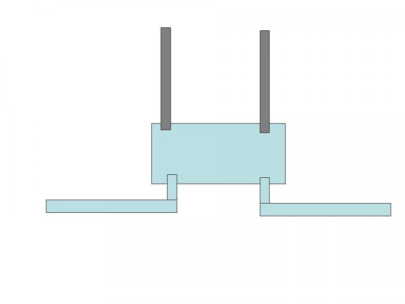

Basic drawing attached - the two grey are what shoot out and are not connected. Will take a proper look tonight.
(expert me !!)
the 2 in the side are inlets the 2 out the top are outlets.
if your running a shower from it they must be connected to something.

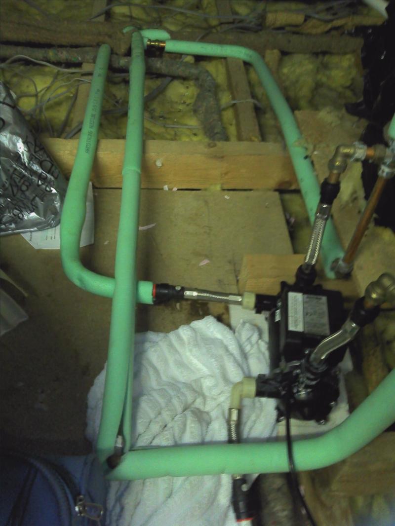

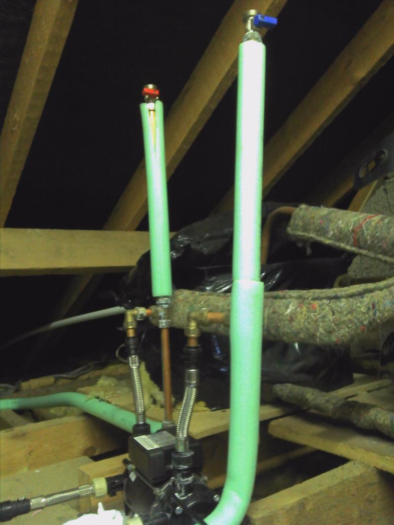

Couple of new pictures attached - I notice that there are connections of the two vertical pipes, just half way up.
I also note that this pump does all my water upstairs. When I isolate the pump I cant use the hand basin either !
