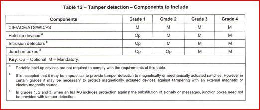

question, on a grade 2 alarm system do your junction boxes require to be tampered to comply with BS
I know this is the case on grade 3 and above systems but i did not think it was the case in grade 2 systems.
Can anyone shed any light on this?

as with all graded system (excluding grade 1) all connection to junction boxes, (and all other devices) must conform to EN50131 and be graded
as such,
if you fit a standard (ungraded) junction box, on a grade 2 or 3 system, the system will have a grading of 1,
as its the lowest graded item on the system.

Its optional on grade 2
Would provide the protection anyway, you really should know this if your installing to grade 2, got a copy of EN/PD??

G2 can be untampered if concealed IIRC.
In my book totally wrong.
Wrong in my book too, for all it takes to do it, just do it
