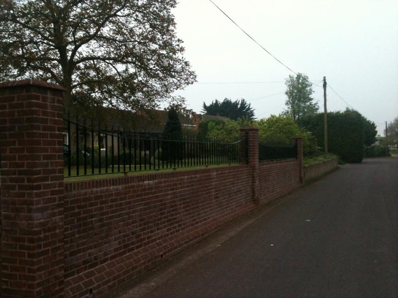

I had something similar built last year at home, it was a lot longer (circa 20m) but roughly the same height with 3 pillars.
I will describe the method below but please bare in mind it is not a straightforward as it might seem as the weight of the soil the wall holds back is scary. Anything less that 'substantial' preparation will result in it being pushed over, eventually leading to collapse!
The builder did as follows:
850mm wide footings dug to 600mm deep (it would have been deeper but he was happy he had reached firm subsoil). Filled with readymix to 50mm below finished height. Steel reinforcing mesh then laid onto the wet concrete and then the final 50mm poured.
Once gone off the inner skin was 100mm concrete blocks laid on the flat but sideways (called a header bond) with a stretcher bond behind it (overall a depth of 655mm). Under the first course you need to trap the end of a roll of membrane all the way along. Something like this:
http://www.toolstation.com/shop/Hand+Tools/Landscape+Fabric/Landscape+Fabric+2m+x+50m/d10/sd3225/p39101
The next two or three courses (cant remember as it is all buried!) is also a header and a stretcher course. At the appropriate height you need to add drainage outlets, I used square section guttering downpipes cut to the correct length as they are the same size as the height of a brick used for the outer skin. In my case the builder worked out exactly where they went so he could build them in, but he said that often you leave a reasonable gap in the inner skin so you can move them around to suit the external brick face.
Once up to about 4 courses the inner skin then became just a header course (440mm deep) which continued for another four or five courses (remembering to add wall ties as you go to tie the outer skin to!).
After another 4 or 5 courses the blockwork changed again to a normal stretcher course (effectively you are making a stepped inner skin) and continued until you are about 5 brick courses below ground level. The inner skin then became a 100mm block laid on edge - just one block high.
We then backfilled between the inner skin and the membrane with a 50-75mm thickness of 20mm stone which acts as drainage and keeps the soil away from the wall. The top of the membrane is then 'sealed' by trapping under the first course of bricks that is added to the inner skin (done this was so you don't see the blockwork from behind the wall).
Once gone off you can then start to backfill burying the membrane, stone drainage, and blockwork.
The outer skin is then a case of 'normal' bricklaying until you get to the top. I then finished off with a soldier course to close the gap between inner and outer skins but you could equally use paving slabs, concrete capping or roof tiles depending on what finish you wanted to achieve.
In my case the inner skin consumed nearly 1000 concrete blocks so as I say above please don't think it is a cheap project as that alone was nearly 1k buried underground without the cost of the readymix etc.
I appreciate the above is quite complicated to understand so feel free to look on Google Streetview on postcode BA20 2HE and you will see the wall part built (inner skin only in place) as it just happened to be half done when the streetmapping was carried out in our area!!
The finished result is below:
Hope this helps - if it doesn't make sense please shout!!
Good luck with your project.
Nick
