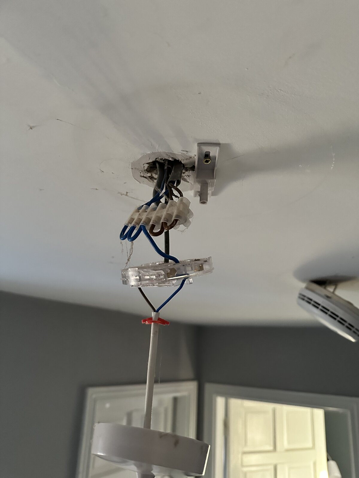

Same situation , landing light, two switches, needed to add larger 6 screw in strip to hold wire connections, switch’s & light working fine. Now looking for a long narrow box to go around the 6 screw-in strip seen in the picture , so I can push it into the ceiling hole. What would such a box be called?

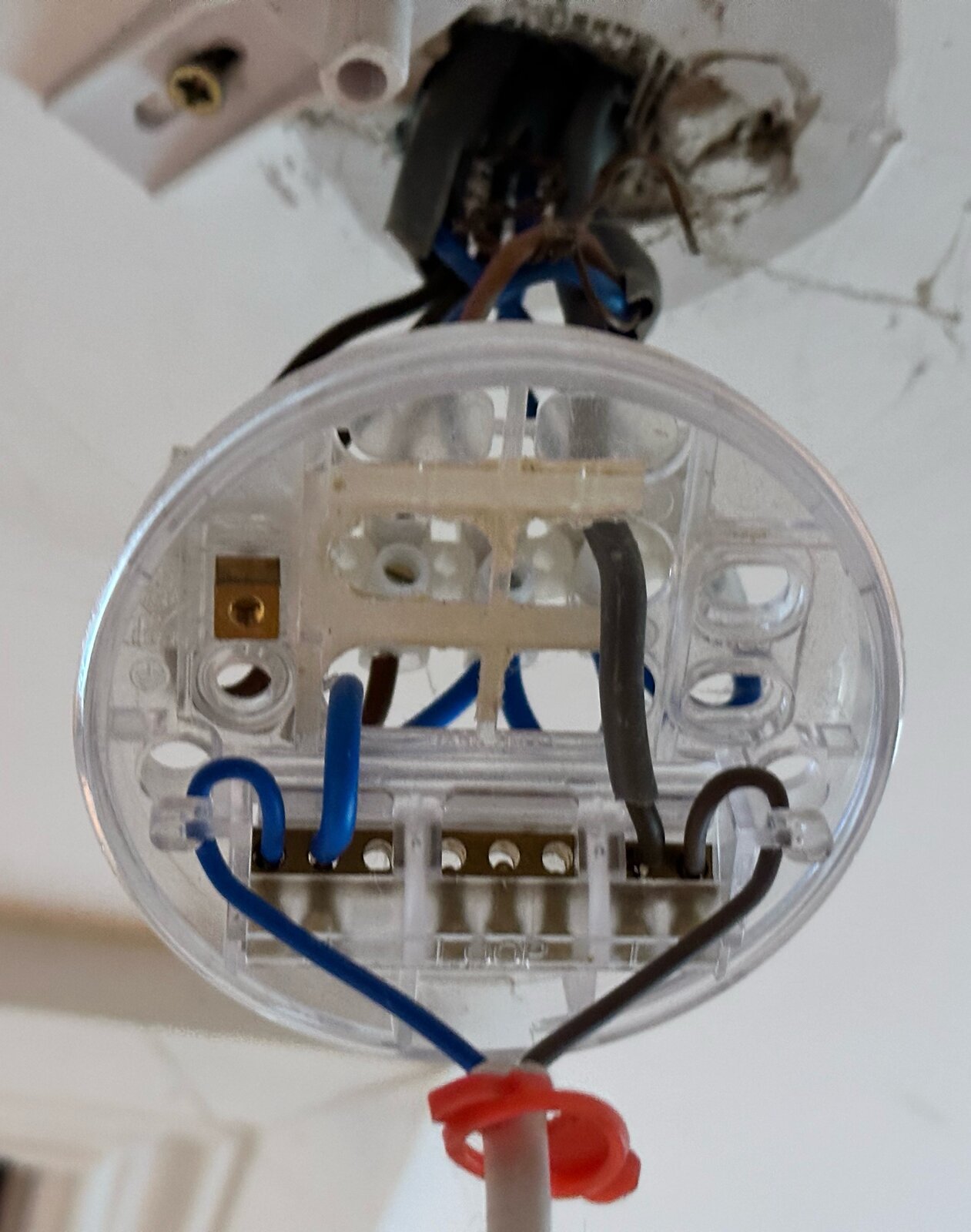

Have you got a picture of the inside of the new fitting? You'd normally dress the cables into connectors in the base of the fitting, however there are some double insulated fittings, which would cease being double insulated if you did this.
Here is a photo of the wires strip in the light fitting, too small to hold all the wires

Yes, replaced old light fixture, copying wiring to this fixture, just not enough space for all wires so added the 6 screw-in strip, but now need to tidy this up, I do have access to both sides of the ceiling.
Thank you for ur replies, No earth wires when I started. I did not question the layout of wires, as it worked with the 2 switch’s so I just copied what was working. I will need to think out the logic of ur wiring layout, makes more sense, will try it out later, unfortunately it not my next fix for today, first need to fix a 3d printer
