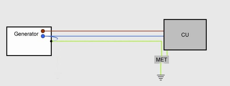

I think this is probably still OK, but would appreciate any comments....
Something approaching 20 years ago, following a period of significant power cuts, I made some provision for generator back-up to maintain the CH system and a modicum of lighting during power cuts. Ironically, although it’s been tested fairly regularly, I don’t think it’s ever really had to be used in anger!
Rather than getting involved with a C/O switch, at the time I decided to go with a totally separate ‘installation’ for generator derived power. There is a (2kW, I think) portable genny located in an outhouse. Its output is plugged into a wall mounted (male) 16A ‘socket’ and thence via underground SWA to the house.
In the house, there is a mini DB/CU for the generator supply, with a 30mA RCD and a single 6A MCB. This ‘installation’ has a TT system of its own (the house is also TT), with its own earth electrode, and also has MPB. The one (6A protected radial) final circuit supplies a few lights scattered around the house (dedicated, totally separate from main house lighting), now CFLs, and a couple of sockets, all of which are clearly labelled. One of the sockets is designed to serve the CH system. The entire central heating electrical system (boiler, timers, pumps and motorised valves) is normally supplied via a single 13A plug (3A fused) plugged into a socket on one of the ordinary RFCs (rather than the more usual connection via a FCU). The ‘generator-supplied socket’ is adjacent to this one, so that the entire CH system can be unplugged from ‘the mains’ and plugged into it if necessary (without the need for a C/O switch).
This system appears to be in no way ‘broken’ (and probably even compliant with current regs), so I personally don’t see any need to have it ‘mended’ in any way. Any comments?

Is the neutral earth link present in the generator?
How do you mean the generator has a TT system of it's own?
It is often confusing but what you are more likely to have is a TN-S or an electrically separate system (no N-E link) with a small 2kva genny. The norm in this situation is the electrode being the means of earthing.
That is unless of course you have an electrode tied to the neutral in the generator which is not directly connected to your house, using the general mass of earth for the connection to your house?

Starting at the end ...
No, I am not doing that. Returning to start of the message:
It does seem a bit confusing (at least to me!), but I think this becomes essentially a game with words, doesn't it? If the genny's 'N-E' link is present and one connects a single earth electrode to the genny end of the 'earth' connection between genny and installation, then I suppose what one has is TN-S. If one connected both genny (with N-E link) and installation separately to two separate earthing electrodes (without any earth connection between genny & installation), then I would call that TT. When the connection between installation 'MET' and genny frame (and also N-E link) is present and a (single) earth electrode is connected to the installation end of the connection (which is the situation I have), I'm not really sure what one calls it - the only connection of neutral and earth at the supply end is then 'backwards' along the connection between genny and installation - something one never (to my knowledge) ever sees with mains supplies. Yet another configuration I could consider would be to connect the (same) earth electrode to both ends of the connection between genny and MET - which would be 'sort-of TT', and seemingly a bit silly! In practice, I'm not sure that there is much material difference between any of these situations (whatever one calls them), is there?
Are you perhaps suggesting, by implication, that it would be better to have the earth electrode connected at the genny (making in TN-S).and hence connected to the MET only via the connection between genny and MET?
Kind Regards, John.
(meters & cutouts etc omitted for simplicity)
(no words but lots of diagrams and a question mark)
Well, yes, I think those diagrams all correspond to the prose of my last post. However the point I made is that what I have at present (designed and created many years ago) is actually none of those - it's like TN-S except that the one and only connection to earth (forgetting bonding) is at the MET end of the connection between generator and MET, not at the generator end - and, as I said, I don't know what, if anything, one would call that.
We're only talking about a few feet of connection, and that is by means of SWA core+armour, so I think this is probably all pretty academic, but do you think it would be better to move the earth connection to the genny end, so that it was true TN-S?
Kind Regards, John.

I really don't think it's very right to call it TN-S, since the feed from the supply (generator) is not providing (unless the genny is sitting in a muddy puddle!) any path to earth for the installation. If one removed that connection and had just two-conductor (L & N) feed from the supply (generator), it would be an IT system - but that connecting earth wire means that the installation (via it's earth rod) is providing a path to earth for the supply (generator), not vice versa as in a TN-S system. Just to be sure that everyone understands what I'm describing in prose, I've plagarised one of BAS's diagrams to illustrate, namely (sorry it's small - just click on it :)):

Yep, I'd class it as TN-S
The supply neutral is earthed ("T"), there is a direct connection between the consumers installation exposed metalwork ("N") and it is a separate conductor ("S").
It's all really just a question of words (or letters!), but I have to say that I still wouldn't class it as TN-S, and I think the problem with your logic is that you are not distingusihing between the 'supply' and the installation. Maybe a slight modification to my diagram will help:
I don't have a copy of IEC 60364, but it is clear from every source which gives information about the classification system that the first letter relates to the connection between earth and the power supply equipment, whilst the second letter relates to to the connection between earth and the supplied installation. That being the case, and being careful to distinguish between supply and installation, as far as I can see for TN-S ...
The 'T' means that one or more parts of the supply (generally the neutral, at one or more places) are directly earthed
The 'N' means that the exposed conductive parts of the installation are connected to earth via the earthed supply conductor provided by the supply/supplier.
Put in everyday language the separate ('-S') conductor of the supply is providing an earth for the installation, not obtaining a path to earth from the installation.
I don't really think that the arrangement I have described (per diagram above) satisfies any of that.
Think of a standard TN-S setup and consider the situation if the DNO removed all connections between earth and the generation and distribution network (which they obviously would not be allowed to do). It is no longer a TN-S system, because there is no connection to earth anywhere, and the incoming separate earth conductor would be connected to the DNO's 'floating neutral', rather than providing a path to earth. If a consumer then connected their MET (which in turn is connected to that incoming 'earth') to a local earth electrode, that would not (IMO) turn it back into a TN-S system (and goodness knows what currents would attempt to flow into that earth electrode, particularly under fault conditions of either the network or any consumers' installations!).
However, as I think we've probably already agreed, it doesn't really matter what one calls the system I've been describing,which does effectively, albeit not literally, have the characteristics of a TNS system.
