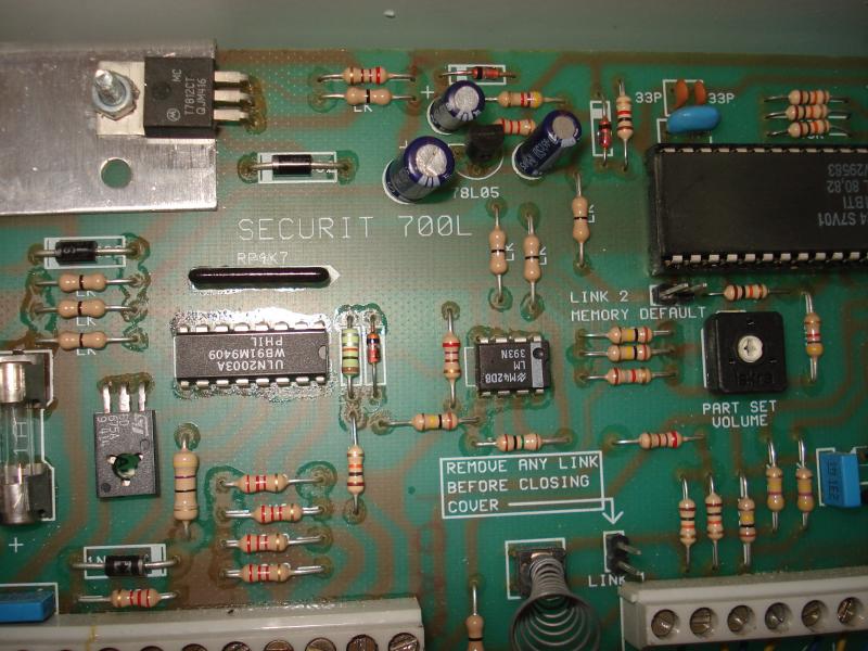

Hi can anyone tell me the procedure to return my securit 700l alarm back to default user codes i have tried putting the link on the pcb for defaults and then powering up but its not altering it and i do not get an accept tone from the panel,also the battery is dead would this effect it.

Oh yes, a 'duff' battery will make any panel do funny things, or, nothing at all.
I'm afraid I don't know your panel so I can't confirm or not whether you are doing it correctly or not.
Why do you need to Default the codes?
Can't you just change what you have with this panel?

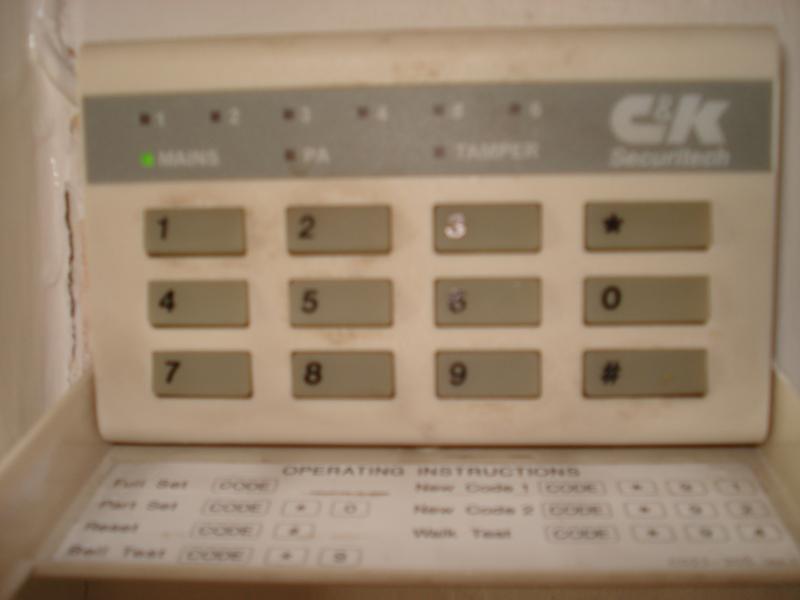

hi what you are doing sounds correct are you definatley shorting the correct link as there are two sets one for tamper and one for the nvm reset also are you sure its a 700l pcb ? how many lights on your keypad? worst case get in touch as i think i have a spare kicking around if that does not work. thanks mark
sparkymarka i have taken the transformer out of the old panel and put it in the replacement ,then did the procedure to default the panel and eureka its worked don't know why but it worked i only changed the transformer because it was buzzing thanks for your help and advice .
