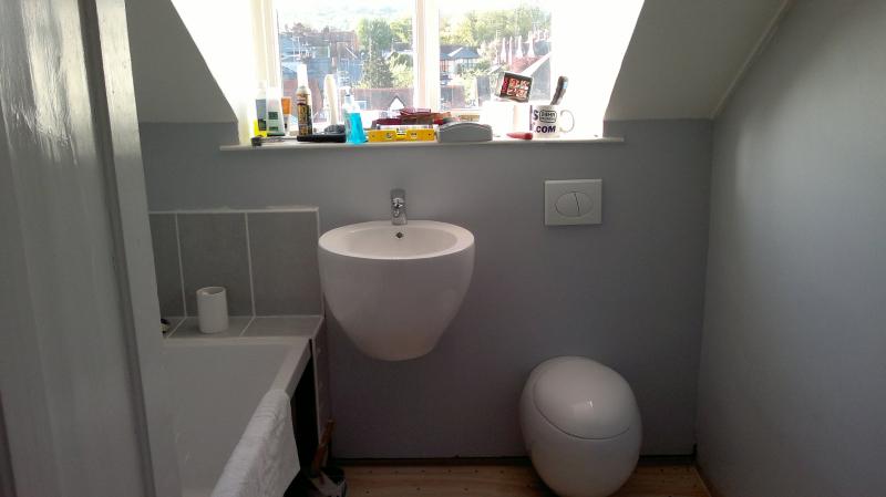

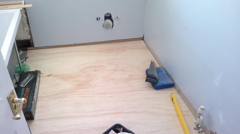

PostPosted: Tue May 03, 2011 12:16 pm Reply with quote
Thanks,
But do I need to add more ply on top in the deep areas to save on levelling compound as it states no deeper than 10mm..?
I have added pix as promised.
Franc

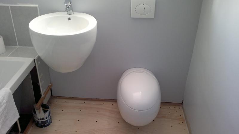

PostPosted: Tue May 03, 2011 2:29 pm Reply with quote
Nice Bathroom
...only a small niggle - I hope tour toilet connector has been planned with the (eventual) increased floor height in mind ....it looks like you have but just wanted to check before its too late!
...keep the pictures coming - I would love to see how it turns out

PostPosted: Tue May 03, 2011 2:57 pm Reply with quote
Yes, the photos look a bit out of perspective, the toilet floats a good 3 inches above the ply at the moment, so should be fine.
Thanks for your feedback.

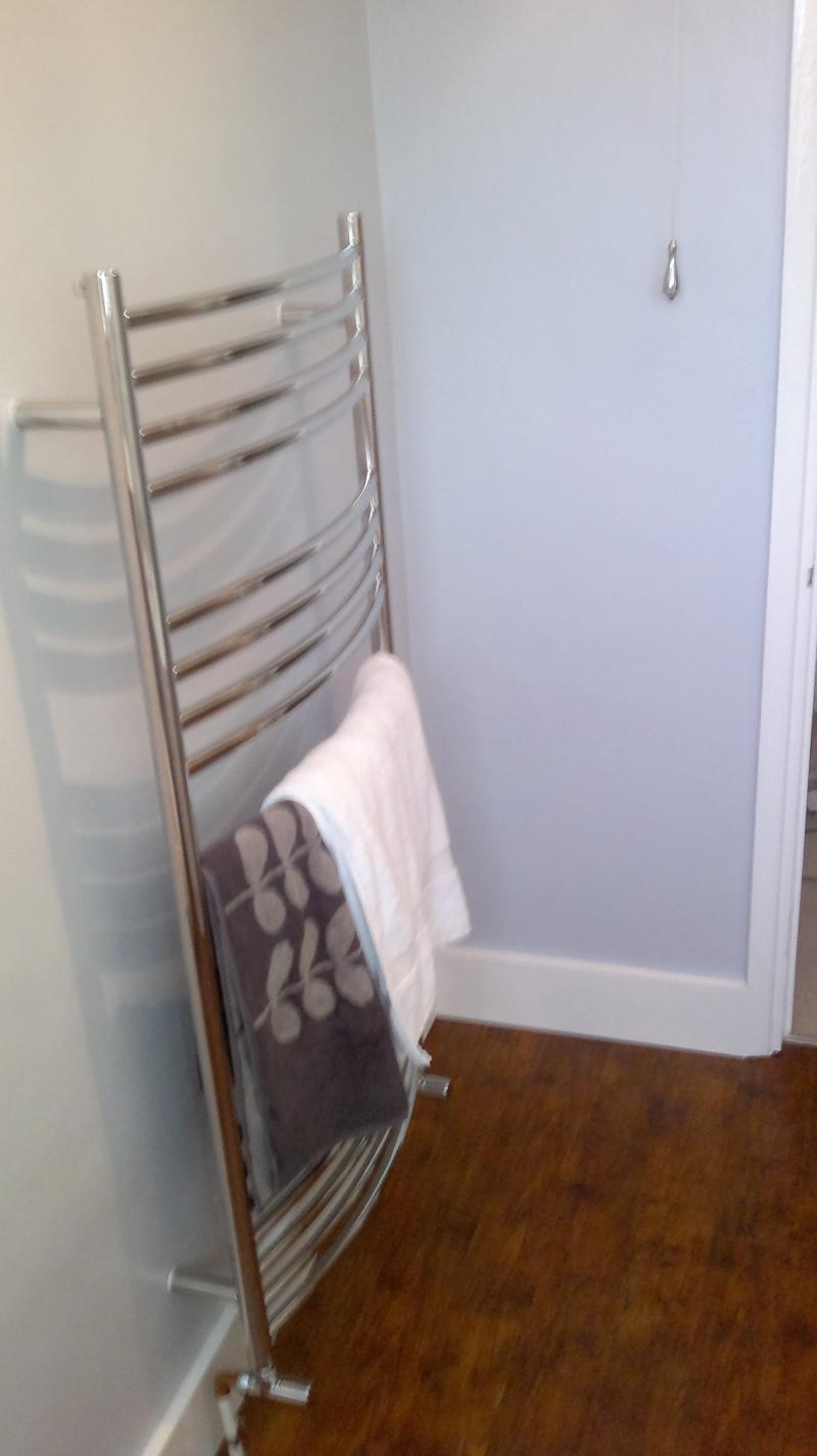

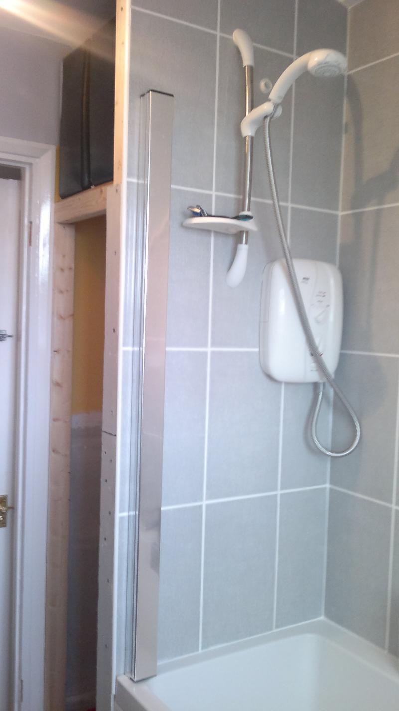

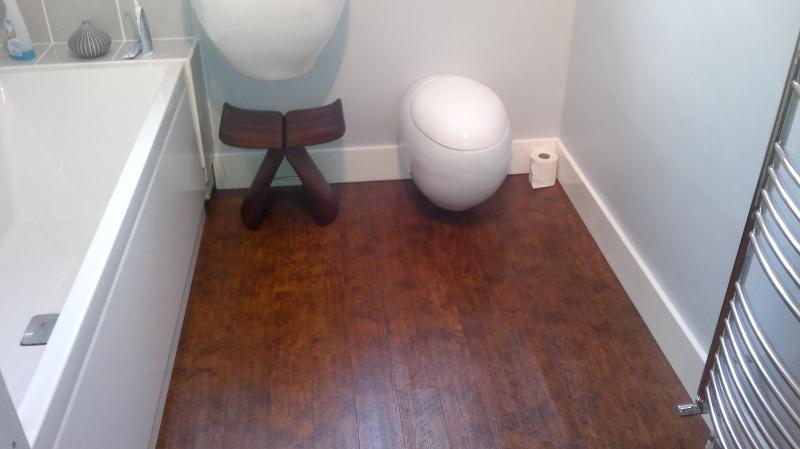

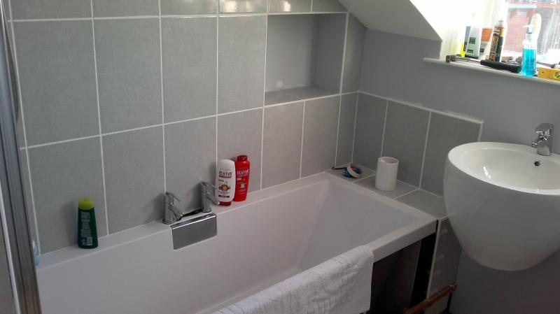

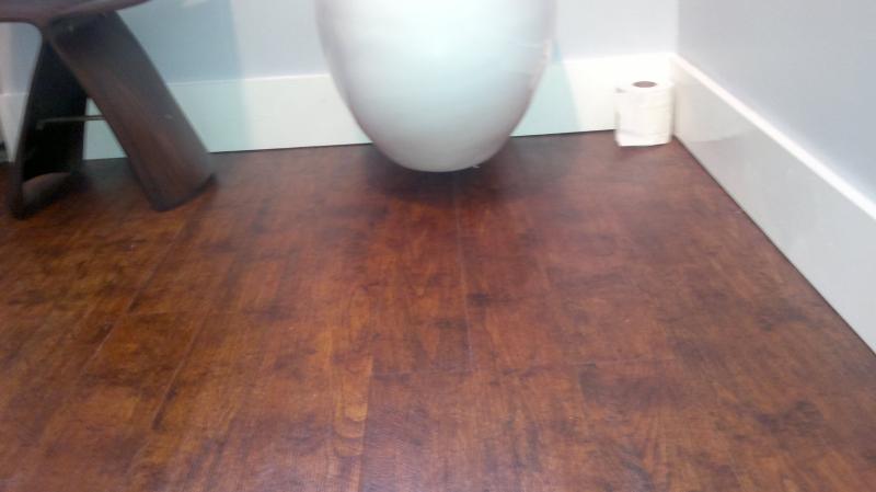

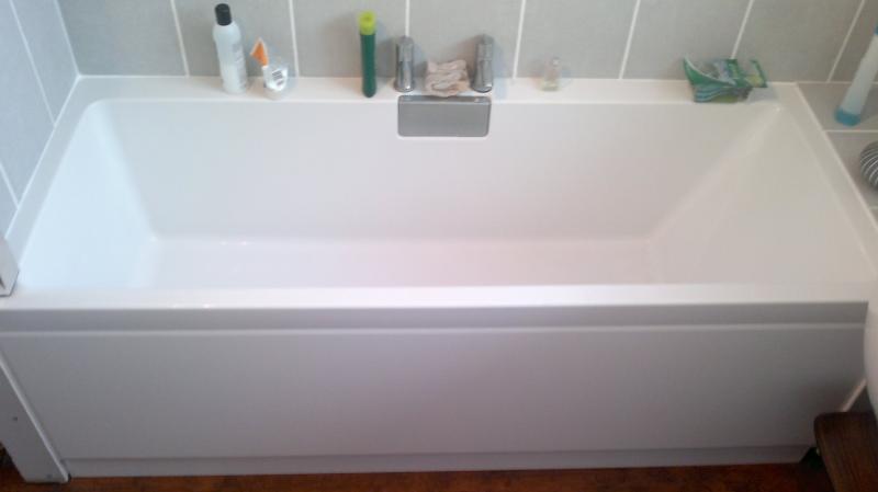

PostPosted: Thu Jun 02, 2011 9:13 pm Reply with quote
Latest photos as promised.
Just need to finish off some skirting and construct shelves under the water tank.
Amtico was a dream to work with, I was worried about using a stanley knife to cut, but was fine.
