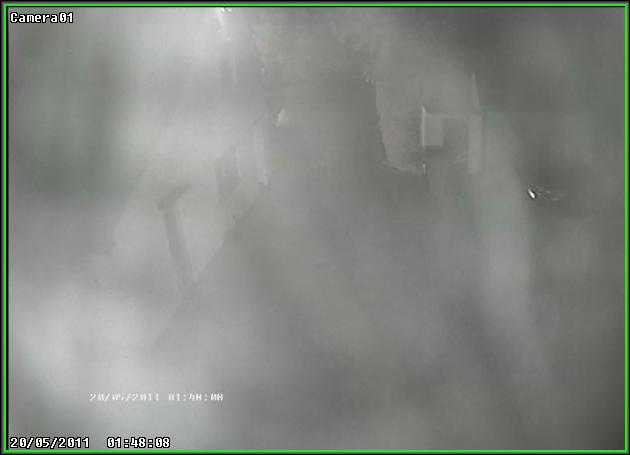

Hi there, i have a few issues with 2 dome camera i have installed onto my system and wonder if anyone could offer some advice?
The problem is at night time the screen just goes all “foggy” and you cannot see at all, during the daytime they are very clear. When i take the outer domes of the picture is much improved.
They are good quality external cameras with built in infrared lighting,
I do live in a rural location with no street lights etc,
Here are the cameras i have
http://www.y3k.com/product.php?xProd=3854&jssCart=58bee99a69deb2fa043f1bc8b839edb9
http://www.y3k.com/product.php?xProd=1795&jssCart=58bee99a69deb2fa043f1bc8b839edb9
I feel the glare from the infrared is projecting back onto the domes??
Any thoughts
No misting in the daytime whatever the conditions?
My guess is no.
LED`s set inside same dome as lens = as you say reflections.
Send em back, get something with the leds in an outer ring, seperate to the lens.

No misting in the daytime, i have another camera which is a Samsung non dome type, like you say with the leds around the outside and that is fine dunning the night time.
I just don’t get why make / sell a product that does not work :!: :rolleyes:

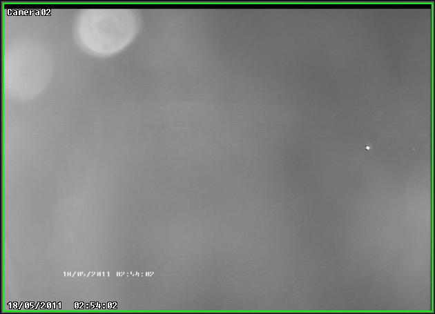

Sometimes the LEDS are too powerful ( but not generally) and can cause the reflection you see.
Try moving the dome and repositioning the lens slightly, or dont fuc about and get them changed to the samsung.
Glare/reflection.
either way, a pain in the a**e. and not always easy or possible to sort.
I don't use them anymore. Found the Twighlight Pro/Night Devil/Dynamic Pro to be a much better option.
If you want built in IR, make sure it is split lens, then you should have no problems with reflection.
They usually do work initially. But it requires a very good seal around the lens. Doesn't take long for the sun to do it's stuff in shrinking the packing/seal.

Are they really this bad at night ??
That is extremely bad, no good for anything really. if you need ir then i would suggest a separate emitter to be used or some other lighting such as metal halide or cfl lighting.
