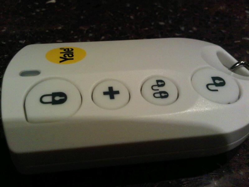

I've had no problems with this alarm until recently I bought a couple of keyfobs, I learned them in and they work fine but since then the alarm has been going off at seemingly randon times when we are home. After investigation I now know that every time I hoover it sets the alarm off!
It appears the hoover emits a frequency the same as the keyfob.
Does anyone have any ideas of fixing this?
Is there anyway to unlearn the keyfobs as I may have to stop using them? If not would I have to unlearn everything and start again and how would I do this?
I have a decent hoover and I dont want to buy another one!

If you use the keyfobs as keyrings and have the fobs in your pocket then unfortunately you are in danger of setting the alarm without realising it.
The buttons are unfortunately easy to be pressed when in your pocket as they are not recessed enough in fact they stand slightly proud.
It may be the action of using the cleaner with your keyfob in your pocket that is setting the alarm without you realising it. (With the hoover on you presumably would not hear the confirm beep from the siren.
Also when you set the alarm with a keyfob as opposed to the keypad the alarm is instantly set and also instantly activated without the normal 20 second delay you get when you use the keypad.
I would try making sure the keys are out of your pocket and the system is disarmed and then try just simply turning on the hoover.
If the alarm instantly activates then you may have a problem due to the hoover.

Secondly you can look at your instructions and in there you will find instructions on how to set one of the white dip switches inside the siren so that it will ignore your hoover and not activate if indeed the hoover is found to be the cause.

The fourth piece of advice is - I don't recommend keyfobs for a Yale system other than as a way to set and unset the system from the comfort of your bed.
I don't like the idea that they can accidentally set or unset the alarm when pressed in your pocket.
You cannot unlearn them from your system as such.
What you will need to do is reprogram the system from scratch.
Follow instructions in the manual to clear the existing settings using dip switch 1.
Relearn the system but this time without learning in the keyfobs.

Its a 6200 with the grey keypad and i've only had problems since I learnt in the keyfobs. They are never kept in pockets we keep them hanging up and the buttons are flush with the case, they have to be pressed with a reasonable amount of pressure to activate.
Going to investigate tomorrow but I think the on/off switch on the hoover is emulating the panic button on the fob. I dont think the alarm is turning itself on as I dont have any PIR's in the lounge & kitchen and all doors and windows were shut so it can't activate.
Will probably end up removing the keyfobs.
Dip switch 2 is interference detection but i'm fairly sure this has always been in the off position.
Dip switch 1 is called Clear On, so if I set this to off it will unlearn everthing so I can start again, and do I also need to switch off dip switch 4 called Master On?

Hi I think you have just highlighted the problem to me.
reading from the top to the bottom your dip switch settings should be as follows.
(4) to the left
(3) to the right
(2) to the right
(1) to the right
If what I have read is correct in your previous post you have
switch (1) to the left!
It should not be to the left in normal use it should only be to the left while you use the learn button to clear the system.
You should only have the top dip switch (4) to the left.
This explains your spurious activations.
You need to put switch (1) to the left but beware your system will usually activate when you do this as the first sensor sends a signal in so be ready with your fob to press the disarm button.

In this case it is not the vacuum cleaner being the problem.
The problem is that the OP has left the dip switch (1) in the wrong position.
Part of the process of setting up a new system is to put the dip 1 to the left then press the learn button of the siren to clear the memory of enroled devices. (Perhaps at the factory every one is tested and there is the possibility they weren't reset)
dip switch 1 should then be switched back off again before commencing to program the siren.
It would appear by the OPs comments that the dip switch 1 is still in the wrong position.
