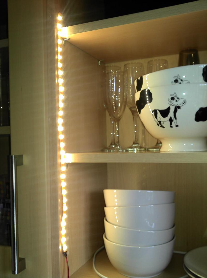

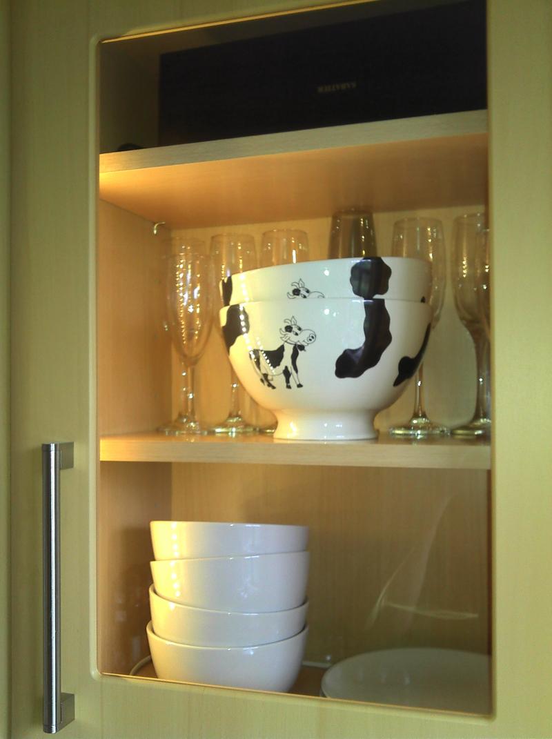

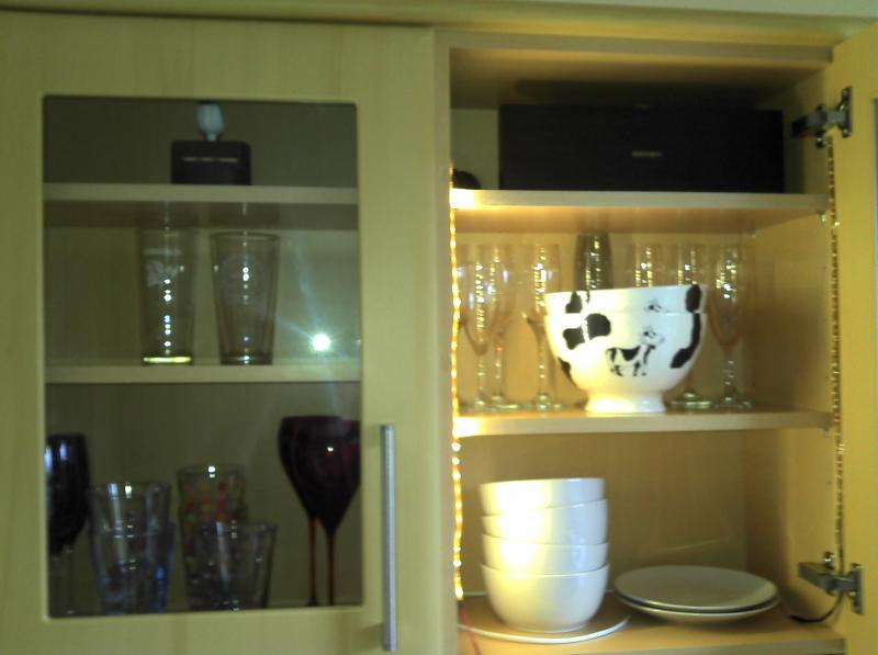

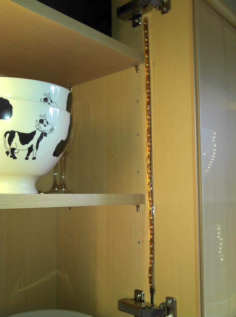

I'm a bit perplexed; I'm looking to put some LED strips inside two new glass fronted wall cabinets, probably on the L&R sides right at the front; but I'm just not sure on the best way to wire them (as in physically run the wires) - my two options considered so far are:
1) Drill a hole in the bottom at the back of each cabinet and run the wires up into here and along the bottom (back and sides) to the base of each strip
2) Drill through the shelf mounting holes between the two cabinets and also through the RH cabinet into the dummy cabinet next to it (has a meter in it and a gap at the bottom/back already) and run all the wires through these
My concern is mainly with drilling holes in three week old kitchen cabinets if there's a neater way of doing things! But I realise that it's likely a necessity... just a matter of how best to do it! :?:
Any thoughts/ideas appreciated!

Good point, coming in from the top would perhaps make sense... I guess the ideal solution would be to drill a small hole above each strip and then wire into a little junction on top?
Well... the transformer is a 'stand-alone' one (?? 'in-line'? don't know how to describe it!) which I've currently wired to a plug for testing, my plan is to terminate this in a switched 13amp fused unit (spur from a double socket above worktop height) on the underside of the cabinets, so yes going back down is preferential...
But having said that, the cupboard I mentioned to the right of these two just hides a meter, so could drop the wiring down through that without any real trouble... :idea:
