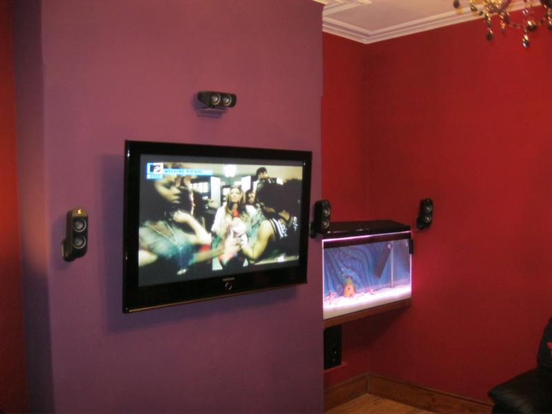

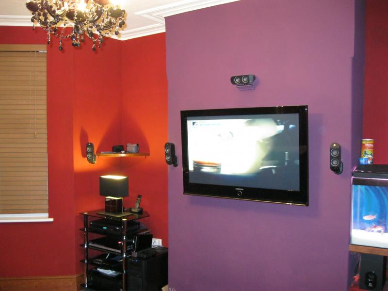

Heres mine showing TV PC and 5.1 speakers
