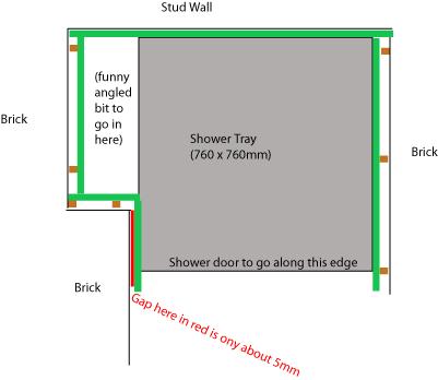

Hi Richard, I've drawn the shower alcove here.
The main issue is that I'm trying to get a 760mm shower tray into an alcove that is, at its narrowest, only about 810 wide. I've battened at one side and that's only left me about 5mm gap between the rough brick and where the Aquapanel needs to be.
I still seem to be missing something here :confused: Assuming were talking about the bit in red being fixed to the wall, the Aquapanel at that point looks to be about 250mm or so wide why cant you get two vertical rows of fixings in there? Ideally the Aquapanel should go down past the tray but it’s not essential.
