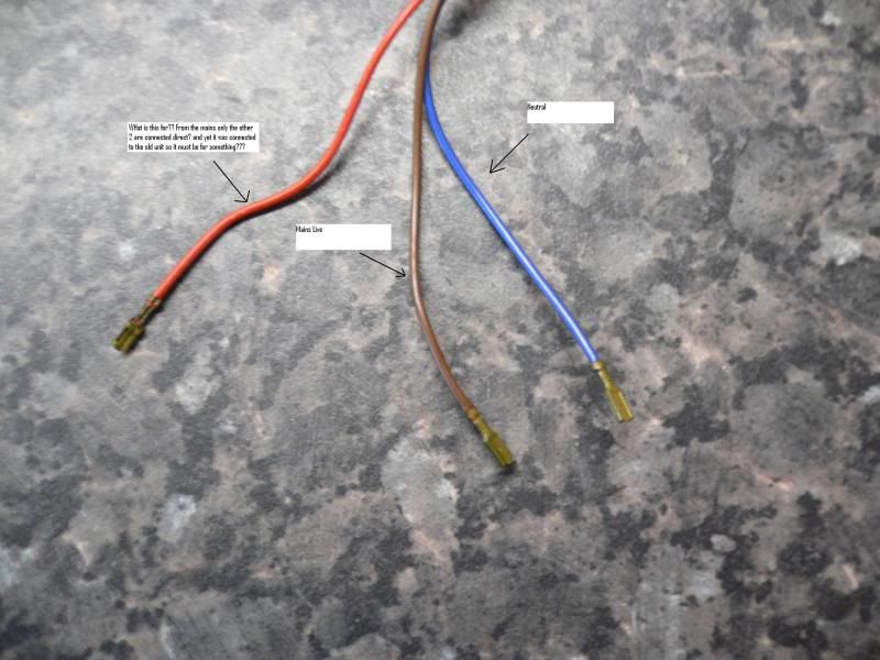

I'm hoping you can help me solve an idiotic problem. I needed to order a new "control unit" ( how they call it a control unit i dont know and justify the price..its a circuit board with a few switches. ) and unfortunately pillock that i am i errr..didnt note down where the wires went ::b
Problem is...I can wire it up so it works...but even in zero position the b****y fan doesnt switch off ::b
I have no iudea what is going on..the wierd thing is the connector to the mains only has 2 wires actually connecting..the brown LIVE and the blue NEUTRAL...but there is a red also that goes to the control unit? I'm assuming where i put this is the problem though am not sure...the lights connect with a red LIVE and a white NEUTRAL wire....

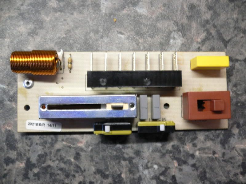

I have got pics below of the "control unit" and the wires... I just literally want to know what wire I put where! ( i know where the red and white from the light switch go. )

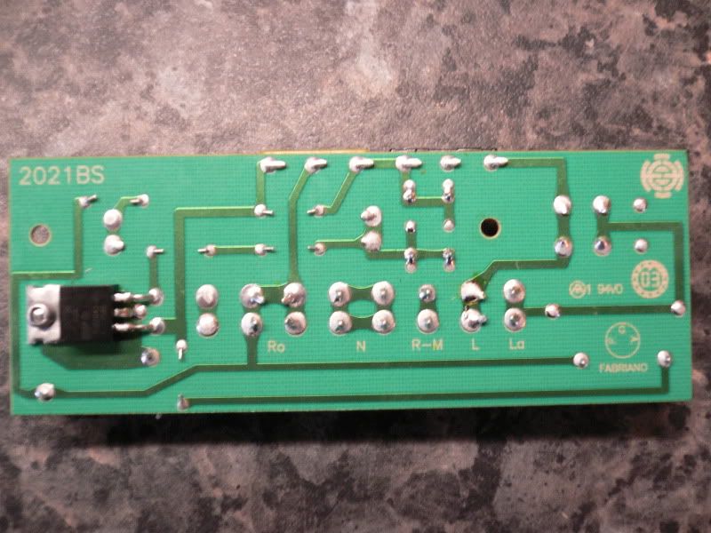

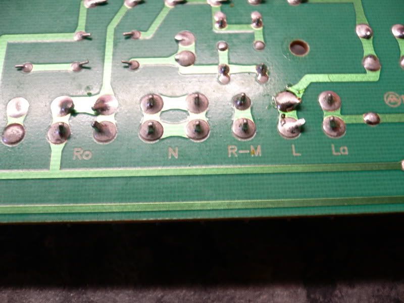

I can't tell you the correct way to wire this...... I could have an educated guess, if you want...
BUT, the bad news is - this board contains an electronic device, (the black three legged thing with a tab) whiich is probably a TRIAC, to do the fan speed control. If you've been swopping the wires around hoping the get this to work, its very possible that you have blown this new board. If you have ended up with the triac connected across L & N you will have killed it.
(Triacs often fail short circuit - this could explain why you cant get the fan to turn off )
