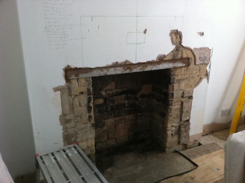

I'm fitting a new cassette wood burning stove in a chimney breast in my lounge. I am just making the opening in the chimney breast but the chimney is not deep enough, I need another 25mm.
I have a cavity wall which the chimney breast is built into. The back of the chimney breast is basically the outerskin of the house (ie just one 4" wall separating from outside)
I don't really want to have to plasterboard and re-skim the front of the chimney breast as I cannot skim myself and I would also need to get someone in to re-do the coving.
Could I chip off an inch of brick on the inside of the chimney breast to get my extra inch depth?
Or Could I rebrick this small section using 3" wide bricks? Are this available or would I need to cut down myself?
How hot does the back of a wood burning stove get? Do I need special bricks?
Any advice/comments would be a massive help, thank u kindly:)

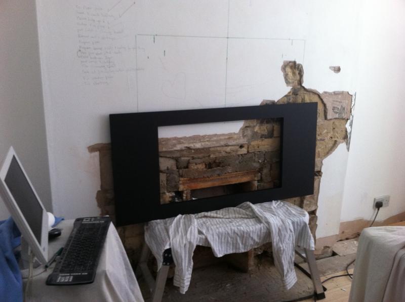

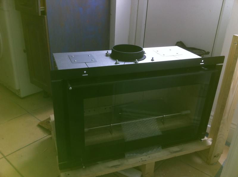

Thanks RedHerring2. Sorry I forgot to say that this stove is an inset stove, so it has a flange around the edge that is designed to be fixed to the edge of the opening.
Ive included a picture so will hopefully make sense.
The builders opening that is required (according to manual) is 735X435 by 355 depth. The maximum depth that I have is 330, annoyingly 25mm too shallow!
Thanks very much for your help:)

I think I have to bight the bullet and put a 25mm 'something' on the front of the chimney breast to get the required depth
Annoyingly, from reading the other posts, I have discovered that even gypsum fireboard is not sufficient as it is just designed to withstand '1 of' high temperatures, not continual heat. All the other brands that were mentioned (Superlux, masterboard and fermacell) appear to all be same.
I have only managed to find advice relating to using a heat resistant render and then skim, which I cannot do myself.
So unless anyone has any other possible ideas I think I'm gonna phone plasterer tomorrow to get a quote.
Thanks again for your input
Infact change of plan I'm going to attempt rendering it myself.
Going to screw strips of mdf to both sides of the breast so they petrude 22mm then render up to these. That way it I can't get it wrong as I can rest a level on the two strips of wood and run it up the chimney breast to scrape of any excess.
I can then get someone in just to do the final skim.
Any points/suggestions I should remember when doing this?

I think the slip r a really good idea, though I'm not sure would go with the black steel surround I chose. The wood burner did actually come with a variety of surrounds. I ordered the 'black brushed steel' surround which doesn't stick out. Annoyingly if I had ordered one of the stone surrounds I would not have had this problem as they are similar size to the slips.
