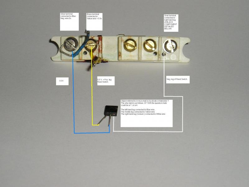

Hi all,
A friend has recently had a door replaced, and the fitters managed to trash the surface mount door contact.
From the photos I have been sent, it would appear to be a supervised loop rather than double pole wiring - and before I head off 60 odd miles to (hopefully) fix, i thought I'd try and ascertain whether anyone can confirm the circuit type, and possible resistor values.
From the photograph I have been sent, i am assuming that the three legged component is some kind of bespoke twin resistor - certainly looking at the wiring configuration, it looks very much like a FSL
The panel is a CastleCareTech SmartId.... i can't get hold of an installation manual online so am unable to tell whether this IS FSL or EOL type wiring without heading over.
I realise that i can probably work it out once there, but as I mentioned, I would like to have all possible components with me so that I can fix in a single visit. (Doing this for beer tokens rather than cash!)
NB The text in the photo was added by my friend, not me!
A bit more digging has established that it is using SmartID technology, and it looks like the component will need to be replaced with a like-for-like SmartID biscuit.
Off to google then.....
The chips (or biscuits) are fairly robust, the panel will be showing fault due to the missing addressed chip, it might need nothing more than connecting the one removed back on the data detection line (Blue/Yellow convention)
The chips are numbered for addresing purposes, to save a small ammount of effort in programming, try and get the same number if the original chip is u/s.
Just noticed the switch wire leg has snapped off, that complicates things unless your a good solderer.
You will need a new ID Biscuit you will never solder it back together.
Get the number on the other side of it to save programming issues.
If your really lucky there might be some spares in the panel. I always left a couple in there.
Like hens teeth getting the old white original iD biscuits. You'll be very lucky if you find any on t'internet
