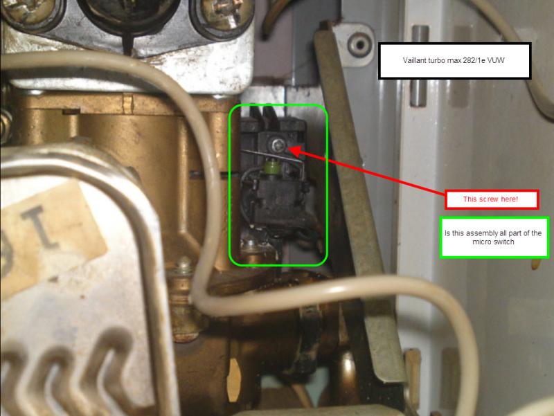

Guys,
Please can you assist.
My brother inlaw has boiler prob where hot water demand is intermittent and/or not hot.
Has had the diverter valve replaced and this seemed to work for a short period.
next to the diverter valve is a unit with an arm which goes to a micro switch, I believe that this is the switch for hot water demand, and could be causing the problem.
he tells me that if he releases the screw holding this unit and realigns the unit then it will work for a short time again.
I think it possible that this unit is moving due to the screw working itself loose from the function of the hot water demand and needs a spring washer under the screw holding the unit from the picture he sent me.

Hello Guys,
Since posting the first message I now have a copy of the manual.
All I require is some decent advice please.
Having looked at my bro inlaws photo in detail i'm not really sure if the diverter has been replaced as I'd expect to be looking at a new unit not one that looks like its been there over 10 years. I've asked my bro inlaw to check and find out what he actually did for £200 previously. I think he could be pulling a fast one myself and am waiting to hear back.

Rotate the switch fully clockwise and secure with the screw. They don't normally come loose unless the threads been damaged.
Have you checked the microswitch contacts with a multimeter?
Does the DHW Led on the front come on each time with a DHW demand?
That diverter looks old...corrosion over the screws etc. Perhaps it was just the diaphragm that was replaced.
If it's a diverter issue, then on a boiler that old I would replace the whole part. Often the seals can fail in the top part of the diverter (leaks) or the plastic arm can fail causing sluggish operation on the microswitch.
Diverter is around the £100 mark for a genuine one. Also replace the auto air vent and re-charge the expansion vessel. If it's done properly with the required safety checks etc £200 is a bargain. Generally a straightforward job but not always. Getting the pipework off on the RHS can sometimes mean cutting out the PRV pipework, the pump plate screw can shear off, the differential switch assembly pipes can block on the boiler drain down and you don't get all the seals with the new diverter.
