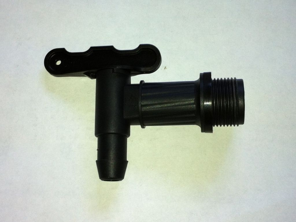

I have a water butt which comes with a plastic tap. I'd like to replace it with a better tap, but I'm not sure what thread it is.
I've found a nut which fits it in my box of plumbing bits, so I think it's a standard thread.
Here's the tap.
It measures about 26mm across the thread
If anyone could tell me what thread it is, I'd be most greatful. :)
likely 1" BSP
If you look at a brass garden tap, you will probably has a thread like that which screws onto a brass wallplate, though from memory I think it is 1/2 BSP
:? I suppose it must be based on the internal diameter of a steel pipe.
I'm not sure. I managed to find a 3/4" nut which fits it perfectly.
