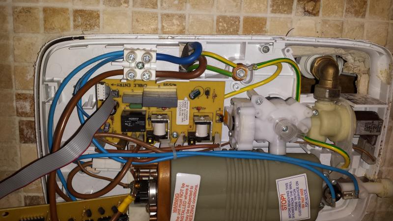

Hi was just wondering if someone could comment on whether my shower wiring is 10mm or 6mm (pic attached).
It looks to me like 10mm but would like a second opinion.

It's always hard to tell from photos, but it looks like 6.0mm² to me.
Is the earth wire from the cable in the green and yellow sleeving a single solid wire, or is it a wire made of several strands?
RF- The earth wire is made up of several strands.
I think they normally use 6mm wire for internals of shower and the feed to the shower from the wall does appear to be larger than that used in the shower itself.
That would mean it is 10mm²

Everything would appear to be alright.
Is there a 40A MCB or fuse?
Is it RCD protected?
Thanks EFL - That is good news, just hope it goes all the way to the fuse box - hard to tell.
There is a 40A RCB and is protected.

Yes. 9.5kW @ 240V = 39.6A
