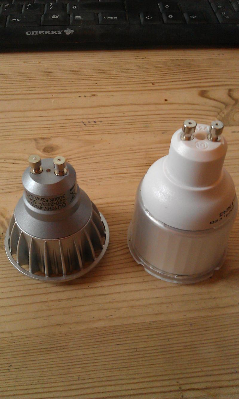

Just over a year ago, I bought these GU10 downlights for our bathroom.
http://www.mygreenlighting.co.uk/low_energy_downlights/led_downlights_ip65/1208.html
The bulbs seem to be TP24 2886.
http://www2.tp24.com/home/index.php/lamps/led/l1-led-3w-lamp-long-neck-2886.html
Three of the four bulbs have now gone, with not particularly high use. ~700 hours. 20,000 hours, my arse :( I have a couple of replacement Diall GU10 bulbs from B&Q, but they don't seem to fit in the mount?!? The TP24 bulb and downlight seems to have a larger dimple in the middle of the two pins which the Diall bulb doesn't have. I guess there are more types of GU10 bulb than I thought? Any ideas which GU10 bulbs might fit these downlights?

L1 bulbs have the same electrical connector as GU10 bulbs, but are only used on low energy bulbs.
The difference is that there is a hole in the center of the bulb between the pins. This is for a non electric pin in the lamp holder to slot into. The extra pin in an L1 lamp holder prevents the use of inefficient halogen lamps while allowing the use of L1 bulbs in GU10 lamp holders.
They are often found in newer houses built when building regulations required the use of dedicated low energy bulbs and in all light fittings from tp24.

The point is that unless you want to argue the toss with an unimaginative BCO, you have to have a number of light fittings in new builds and extensions which cannot take low-efficiency lamps.
