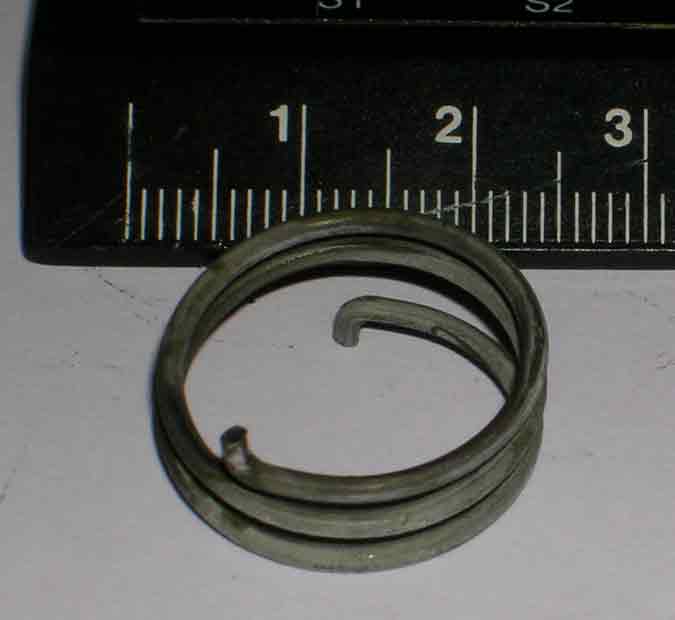

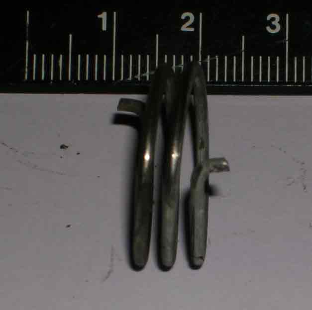

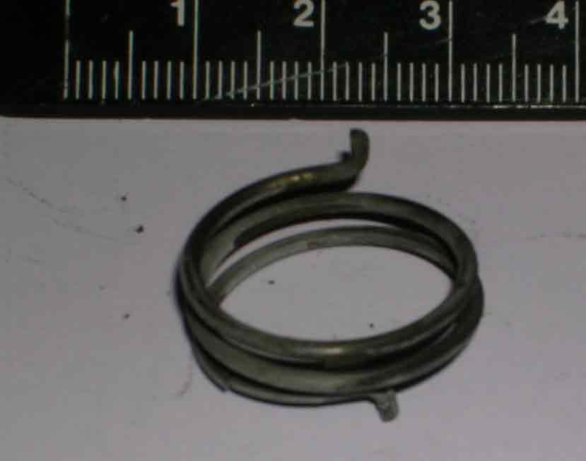

I have several door handles which don't stay horizontal due to the failure of the spring inside the handle. The springs are steel wire approx 1mm gauge, 21mm diameter with 2 and a half turns. I cannot find spares in the DIY sheds or local ironmongers. Does anyone know of any online suppliers of these?
Do you have a picture that you can post ?
I've access to a number of different spring types, and also the spung steel to make them up - but would need to ID the spring first.
I've emailed photos to admin but don't know how long it'll take for them to be posted.
Looks like a '3 open coil', with 1/8th" between coils and 21mm diam.
