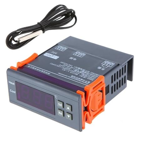

Anyway once my Andoer 200-240V Digital Temperature Controller Thermocouple -40 °C to 120 °C with Sensor arrives I should be able to use that to check the temperature. Then after I can use it to keep my beer at 18 - 20 degrees which is more important.
