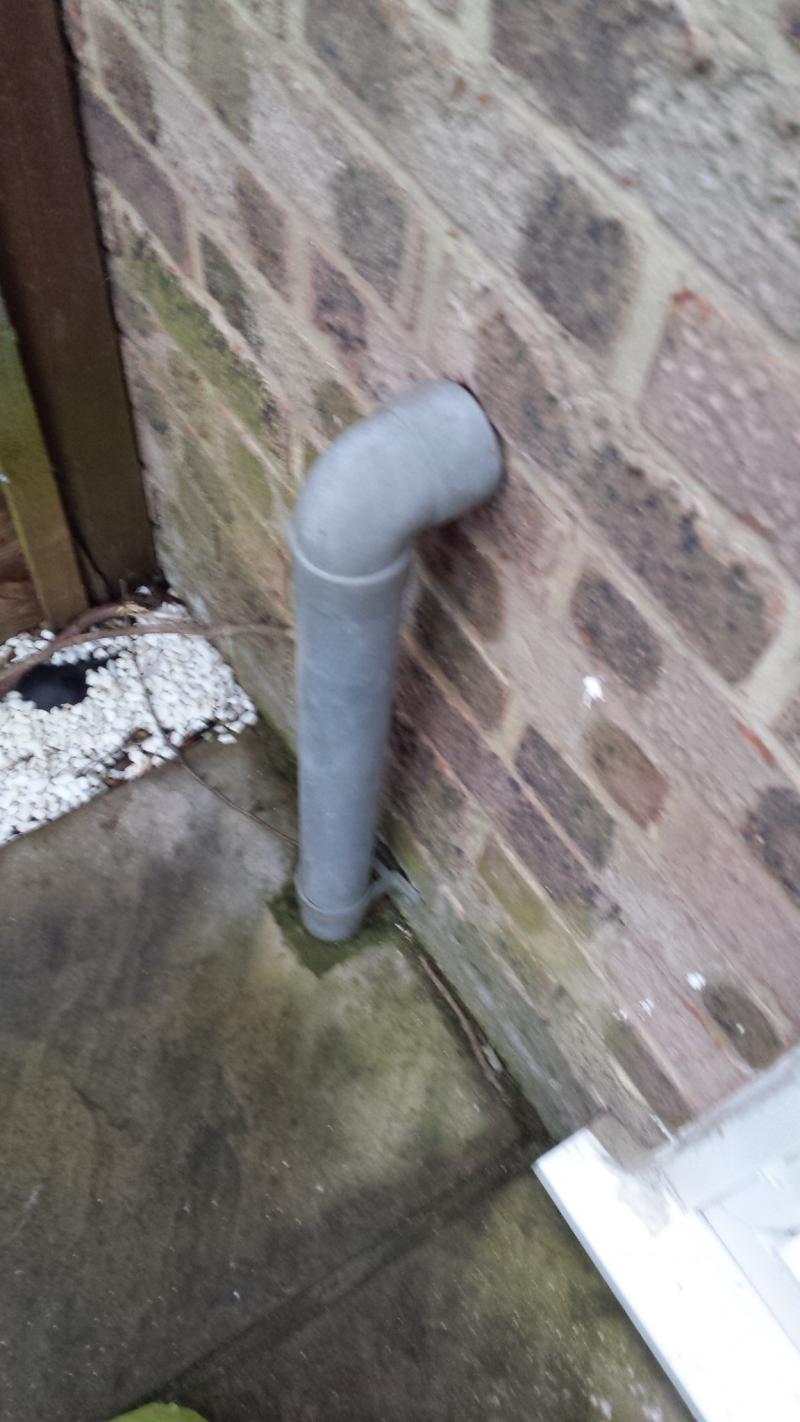

At my house I just moved in, with a garage about 15 metres away.
Info:..
In the garage, there is sockets and lights. All cables is in round trunking. Lights and power all goes to two way fuse board with MCB each, no Rcd.
At the moment there is no power. On finding why, i found the cut cable inside waste pipe attached to house side, reason unknown.
Is it possible to replace main cable between house wall and garage wall which has the same waste pipe attached to garage wall? With new 2.5mm or....?
Also rather than wiring it into a ring final,I will be putting in 2.5mm cable to run from house fuse board to a fuse spur where the main cable come through wall. It will be about 12m long, will it be okay?
I will dig a few holes to find out if the waste pipe does goes all the way.
I will be reducing to a double socket and a light as I don't need much.
Many thanks for your help.
Daniel.
Hi, i would replace with it with 2.5mm SWA and install seperate rcbos in the garage.
Do I take it that you understand that by taking that approach you will thereby be creating a 'new circuit' which means that the work would become 'notifiable', thereby invoking hassle and cost? 'Extending' an existing ring final is not notifiable.

Where the cut cable is, there is 2.5mm cable inside waste pipe and been cut off at house side. There is trace of old chase and screw hole which look like a fuse spur used to be there, about a metre from a double socket.
I thought it would be best to run new cable from house's CU to a fuse spur or a connector box where the swa cable can be connect to, that way if there is something wrong in the garage or underground cable, it will trip on it own RCBO at the CU rather than tripping sockets circuit for whole house.
Daniel.
Very sensible, and has the advantage of being able to turn off power to the shed when not needed.
